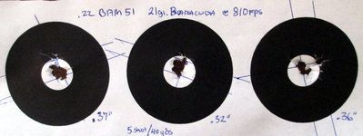

(Cheap) .22 BAM 51
Odd shot string. Got it running at low pressure, but only for a short pressure range (about 45BAR), Not real sure why, but over that range, it shoots very well for 20 shots.
40ayrds
While the shot string is kind of short and the pressure range is kind of small, do believe the efficiency is pretty good.
Something like 1.33 FPE/cu in (or about 12.3 bar cc/fpe).
