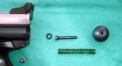

Have been playing with this 2300s HiPac pistol.
At one point I set it up like this:
Striker...spring...SHORT spring guide...o-ring...end cap.

Then I took the same parts ( a different/longer guide) and reversed them.
Jammed the o-ring into the striker...put in a longer spring guide head first...then spring...then end cap
Set up this way, the weight of the spring and of the guide are added to the striker weight (because they move together as a unit).

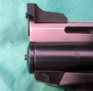

Had drilled the end cap to let the guide poke out just a bit to act as a cocking indicator.

Half the spring weight is moving mass in both cases.... You increased the hammer mass by the weight of the guide and O-ring in the second case.... That SHOULD have increased the airflow, upping the power, and reducing the shot count, as you mentioned.... Perhaps you have a bit of friction where the guide is in the hole in the end cap?.... My guess is that the O-ring is damping the energy transfer to the valve stem somehow....
Since you are using the same spring at the same preload, you have the same hammer ENERGY in both cases.... With the guide inside the hammer, the MOMENTUM is greater, however.... I would like to see the same experiment done without the O-ring on either end.... Make up for the difference in length on the head of the spring guide, perhaps?.... or don't bother and just try it without the O-ring....

No time today....but will get to it this week. Think I'll just make a guide with a head that's fatter by the thickness of the o-ring to keep the pistol in the same velocity area.
