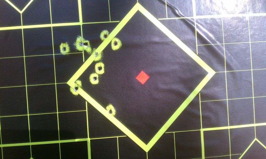

Tried to get some accuracy tests today using bench rest and Scope. Really got mixed up data.
The range is 60' and it was a great morning cool and no breeze. The target is standard sighting in target with the small squares are 1" squares.
First string is Stoger X-Speed pellets 5.56 Gr.
String: 4
Date: 09/24/2012
Time: 11:51:07 AM
Grains: 5.56
Hi Vel: 870
Low Vel: 835
Ave Vel: 856
Ext Spread: 35
Std Dev: 9
Velocity Power Factor Ft/Lbs
859 7.559 14.417
864 7.603 14.585
859 7.559 14.417
862 7.586 14.518
858 7.550 14.383
870 7.656 14.788
853 7.506 14.216
850 7.480 14.116
835 7.348 13.623
854 7.515 14.250

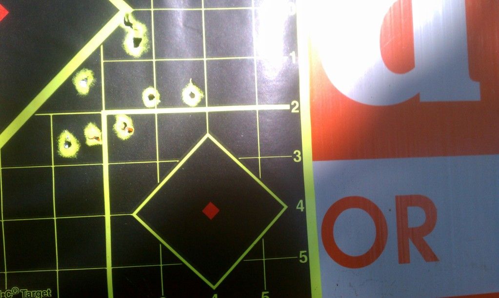

The second string Crosman SSP HP 4.0 Gr
String: 5
Date: 09/24/2012
Time: 11:52:14 AM
Grains: 4.0
Hi Vel: 990
Low Vel: 973
Ave Vel: 983
Ext Spread: 17
Std Dev: 5
990 3.960 8.704
981 3.924 8.547
988 3.952 8.669
984 3.936 8.599
973 3.892 8.408
983 3.932 8.582
983 3.932 8.582
978 3.912 8.495
987 3.948 8.652
986 3.944 8.634

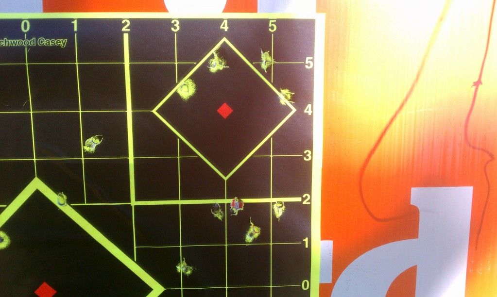

3rd string H & N Crow Mag 9.26 Gr
String: 6
Date: 09/24/2012
Time: 11:49:16 AM
Grains: 8.8
Hi Vel: 739
Low Vel: 711
Ave Vel: 720
Ext Spread: 28
Std Dev: 9
719 6.327 10.100
716 6.301 10.016
711 6.257 9.877
719 6.327 10.100
718 6.318 10.072
732 6.442 10.469
714 6.283 9.960
727 6.398 10.326
739 6.503 10.670
713 6.274 9.933

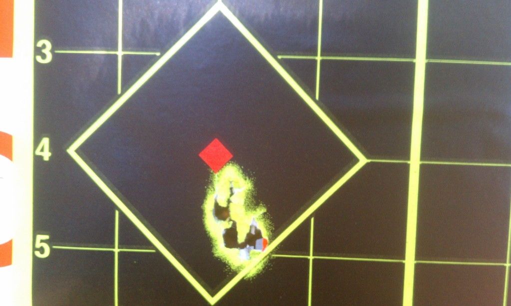

In desparartion I got out my M-rod .25 cal and fired off 8 rounds Baracuda Hunter Extreme 28.4. I am getting ready to get a couple of Raccoons and a Possom cat food stealer. I think this will do the job.
No I don't think it was me. II would like to see more accuracy out of the Rebel. I think I did better with oppen sights off hand. I tried a different Scope but got the same results. Tomorrow I will put the Open sights back on and try again. It is possable the composite breech is causing some problems.
II also discovered that Crosman CPHP 7.6 Gr in the tin and Crosman CP Domed 10.5 Gr in the box will not go into the chamber and/or will not let the bolt close.
Head Dia of pellets
Gamo Tomahawk 0.1765
Crosman Premier Box 0.1780
Crosman Premier Tin 0.1780
So Far I am Not liking the accuracy I am going to clean the bore again tomorrow and try with open sights again on bench rest.
EDIT Added 9/25/12---- Sent email to AOA inquiring about the accuracy of this rifle, included the links to this review. Received a response to email stating they are getting 3/4" groups at 20 yards indoor range open sights with JSB Exact RS pellets. As I don't have JSB Exsact RS pellets I ordered some on a 2 day shipment. Will give results when I can try them out.
