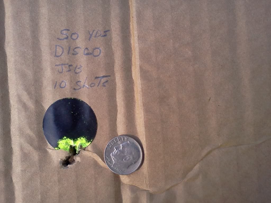

I have to disagree with the statement of accuracy limit on the Discovery. I have 2 that shoot very well out to 50 yards.
With a little work most people can do at home you can improve the accuracy .
I polished the inleade, re crown with a brass screw, and used JB bore paste on the barrel. After that find the right pellet your barrel prefers and you might be surprised at what they will do.
last weekend shot this group of 15 shots at 50 yards with JSB exacts, no sorting or lube.
Sure not all barrels will perform as well as others, but at the price Crosman charges for a barrel why not buy a few and give them the once over.
A few weeks before I shot this group of 10 shots at 50 yards but the conditions were perfect! no wind and my friend had a Caldwell rest for me to use.
