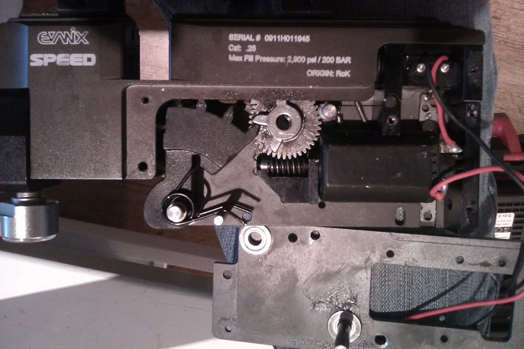

Well my Disco .25 caliber Carbine has finally got started. Now the only thing that has not arrived is the LW 16” .25 caliber barrel and that should show in the next week or two. The Disco Carbine will also feature one of Lloyd’s double tube kits. That is the only way to go for a carbine with high power to get enough shots.
In the pictures you will see the new multi shot breech and shroud w/brass end cap from Sergio at BNM Custom Air Guns. The carbine will be trimmed out with brass parts such as the power adjuster / degasser, safety button that you see in the pictures and coming will be a brass trigger, barrel band, and brass end caps for the air tubes. In the pictures is also the QB78 stock that will used in the final gun and is still having some inletting done to fit correctly. You will note on the right side of that stock is a area marked out in black that I may cut out of the stock, just have not made a decision on that yet. I think it would make the stock rally an eye catcher. Well I had some idle time so I refinished the Disco factory stock and I think it came out pretty nice and will be used for other things in the near future.

Well Mike I worked with Sergio to design this breech with the built in weaver rail, a boss on the end for the shroud and designs on the sides to dress it up. His work is top notch and his idea of the changeable block in the breech makes changing calibers a snap. I have not hand a TKO breech in my hands so it is very hard to say which I would rate better than the other. All I can say is this breech is very well made, real smooth and if the time comes I need another one for a project it will be one of these.
