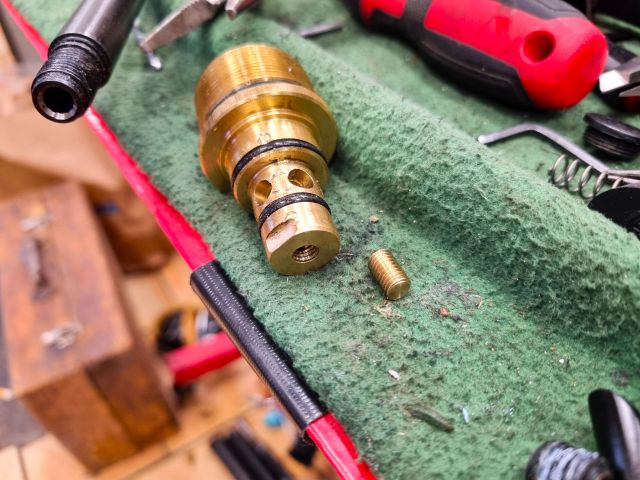

Valve though, same ol same ol. Just this time out all them holes we recognize from BT-65 and so forth, this time out theyīre on a full 6mm diameter.
The by now fabled quattro trigger. No. No, itīs NOT a "match" anything but.. can sure be adjusted to hearts content and thus be had to work within reason and then some.
I still try and get to terms with them tho, in all honesty.
Ah. Then the valve housing. Although it doesnīt come across that well in the picture, again a part with massive amounts of chatter before threading the thing. Itīll work but as a sorts of machinist i have to say that as we see it in more than one place on the gun... nah.
Yeah well, that poppet. No. Just no, so turned an insert i threaded M6 out of bearing bronze and done deal.

Uhu. Agreed on the valve design. TBH iīve got a hard time getting a grip on why Hatsan insists on that valve design.
Some of what they pull off is rather talented in my book, like the replacable poppet seat out of plastic for instance. The multiple exhaust port setup on the Hatsans though, itīs just beyond me.?
So many of us have arrived on, from practical trials, that a "timed" single exhaust port does the job that much better.
Thus the reason to keep with that multiple exhaust port setup... iīve got nothing. Really.

I wondered about the multi port valve, no need to worry about alignment, Just introduce a bunch of lost volume, Yep. For the valve seat, I made the seat out of stainless, and the poppet out of peek, same as the original design, minus the crazy stem. I only have two Hatsan pistols, but I see they use the same guts in a number of guns.

Regarding the Hatsan valve design it IS getting pretty OLD. It obviously works but has room for improvement.
It does make sense to me from a manufacturing POV considering the price point and the target customer. Hatsans ARE "bargain" air rifles overall. I'm NOT bashing Hatsan! They are my FAVORITE air rifle manufacturer BECAUSE they are relatively inexpensive AND can be improved with a small amount of effort at minimal cost.
"Clocking" a single hole alignment does provide that final tuning adjustment that some of us seek. However, I'd bet >98% Hatsan customers don't care about or need that refinement so for Hatsan to implement that change, along with the manufacturing and assembly tweaks required to properly clock a single port alignment, would not be a financially prudent move.
Out of the many thousands of rifles sold with the "no alignment required multi-port design" there have been a few dozen(?) dedicated enthusiasts who plugged and/or redrilled the valve exhaust holes to get either peak energy or peak efficiency from their airgun. It's just not enough to justify the change so I understand why Hatsan maintains that design... for now.

The transfer ports on this thing are ample, to say the least. However the one opening thatīs not on par with the others is the barrel inlet, which is an oblong proposition on a mere 4mm width.
I get why, thatīs not the issue, while if muzzle performance CAPACITY is on the agenda that there thing will put a strangle hold on performance.
So today two things got done.
First up i clocked the valve exhaust. I cut n ground up a set of M8 allen stoppies to handle the task, threaded the openings on the valve body and installed.
Second up i opened that transfer port on the barrel up as i saw fit. Still oblong though, fwiw.
