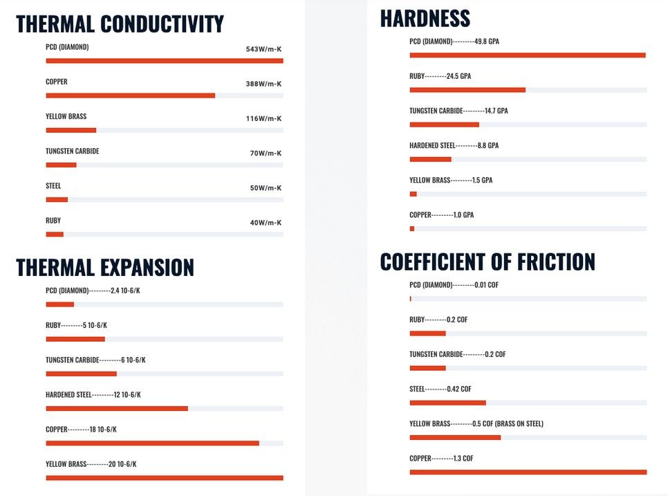

For the pricey diamond nozzle -- it got me thinking -- what makes it print that much better?
Smoothness of the nozzle tip -- I imagine a brass nozzle could be polished, but still not be as smooth. Possibly diamond/molten plastic friction is lower than brass/molten plastic friction as well? Not intuitive, no idea. With my cheapie brass nozzles I do sometimes see faint "chatter marks" on the top surface of a print line as is it laid down -- but do not know if they are due to the nozzle roughness or carriage wheel roughness or extruder pressure... the prints turn out fine, though and maybe that tiny bit of roughness increases layer adhesion, hard to say.
I think the thermal conductivity of the diamond is a bit moot. Copper/brass is pretty good. Hardened steel is awful. This nozzle by nature of NOT being hardened steel is the key. Your hot-end is probably like mine -- has a silicone cover/insulator to keep heat in -- that covers all but the last few mm of nozzle. The diamond is only at the tip, very small surface area, I doubt it contributes much difference to the hotness of the extruded plastic at that point.
Being hard enough to withstand CF is the big plus obviously. I think one of you mentioned the majority of wear is on the nozzle surface parallel to the print bed? Meaning it does wear the brass nozzle shorter, but the 0.40 hole remains essentially the same size until obvious substantial wear has ground it past the cylindrical bore portion at the end of the nozzle? Which would affect the thickness of the first layer of a print, if not Z-adjusted for the wear, but will not affect layer spacing or fusion.
I'm playing devil's advocate I guess -- why I should not outlay half the initial cost of my printer for one of these cool nozzles, when I can get the brass ones for ~30 cents each, or nickel plated copper for about $1 each? Or hardened steel, about $1 each, if my hot-end has the extra range to handle the plus 10-15 degrees C required... (for the CF-PETG above -- it does not...)

Charts from the Diamondback website.... Click to enlarge....
You can draw your own conclusions.... The instructions that come with the nozzles say to run a temp. tower because they print at a lower temperature, and they are highly polished on the end where nozzles wear first.... I bought both a 0.4mm and a 0.6mm, but the 0.6mm is all you need if you are only going to use it for CF filled, I think.... Expensive, yes, but certainly do the job.... I think the combination of hotter filament being extruded, plus more fan cooling, works great, but perhaps there is another reason for the increased layer-to-layer bonding I am missing.... All I know is that it works great!.... 300*C maximum, however....
