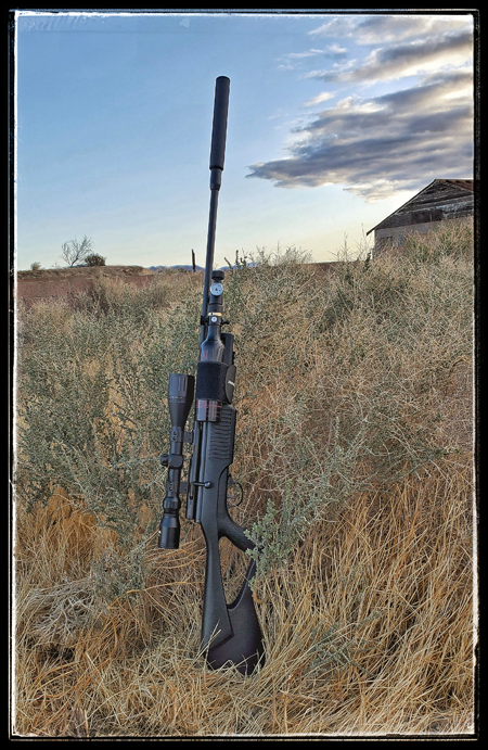

But plenty actually for backyard vermin, I get 6 good shots before needing a refill to 1200-1300 psi. Shot count and bone stock save for bulk fill with check/poppit valve, 3x7x20 scope. 1.687fps, 2.685.9fps, 3.679.6fps, 4.667fps, 5.669.3fps, 6. 662fps using Crosman 14.3gr pellets. 14.46fpe.
