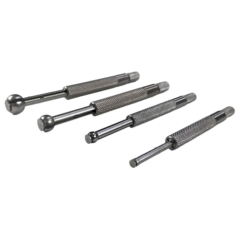

I use a set of these....
You adjust them until you just feel drag, remove and then measure with micrometers....

I have a set of ball mikes, but I don't have the small one to fit the .215" or smaller holes,
As I can't find it in the shop..........anywhere
I think my bench Gremlin has it hidden somewhere.
