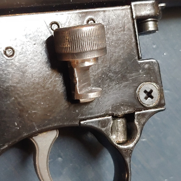

1) Check your rear breech screw to make sure it isn’t too long. If it’s too long (even by 10 thou, it can bind on the hammer spring. The hammer spring gets “fatter” when compressed (cocked) so that’s when the binding is likely to occur… This will reduce some of the hammer energy.
2) If you’re using an over-travel limiting screw, make sure that the trigger can still move about 3/32” after the sear breaks off of the hammer. Some over-travel is necessary to prevent “sear-drag” which will also reduce hammer energy. This problem is due to the hammer o.d. being about 10 thou smaller than the tube i.d. The hammer face / sear angle causes the hammer to tip upward and so the break occurs slightly sooner than if the hammer were sitting level with the tube. The sear needs to clear that additional 10 thou, and with the lever ratios you’ll need closer to 30 thou on the trigger.

With everything deburred and polished, and the hammer dry-lubed, your hammer should slide forward in the tube by raising the back of the tube less than three inches:
