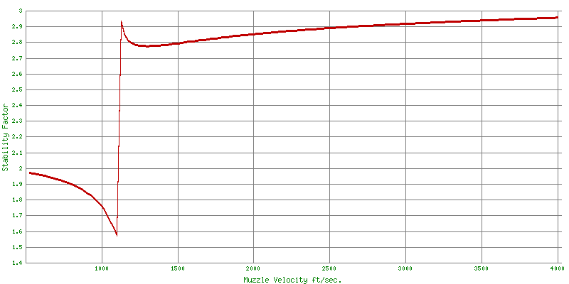

Re: NOE 50 grain airgun slugs
December 24, 2020, 04:09:52 PM »
In the subsonic range, where airguns operate, stability increases at lower velocities.... The worst stability occurs just below Mach 1.... Don't be afraid to try slugs in the 500-700 fps range....
The above is for a 257420, note how the stability increases as you drop further below Mach 1.... the left hand edge of that chart is 500 fps....
Last Edit: December 24, 2020, 05:37:37 PM by rsterne
