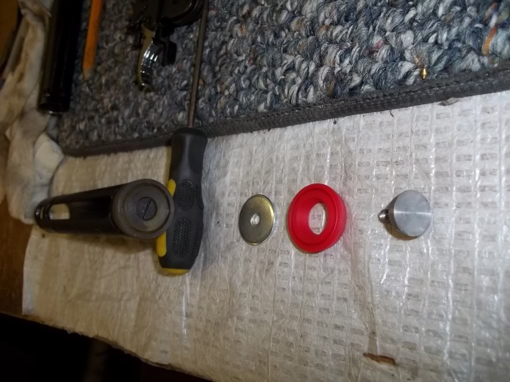

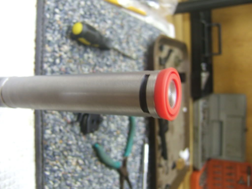

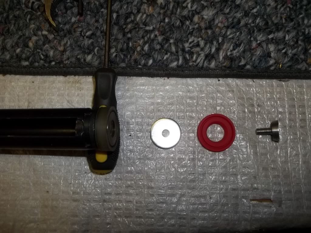

First, my apologies if you all have seen this post in other gates, but I thought it worth repeating here as well.
If you have a Crosman Titan or a Benji Titan (or you might be able to replace the shroud of a Trail with a brake from a Titan), you might not need one of them. I shot three groups of 10 pellets each at 20 yds from a bench with a CP 4-16X40AO scope set at 10X. The pellets were 14.3 gn CHPH and Crosman Pointed. The first two groups are with the brake bottomed out on the muzzle. Physically, there is no way for the pellet to strike the brake after exiting the muzzle unless the crown is really messed up.
I loosened the two set screws just enough to move the brake. I set it to where the two set screws are about 1/2 inch from the muzzle of the rifle. You can clearly see the difference it made in the third photo. I shot five CPHP and five pointed with the same parameters as above.

group is tighter...dang...English House Sparrows just hate that.
