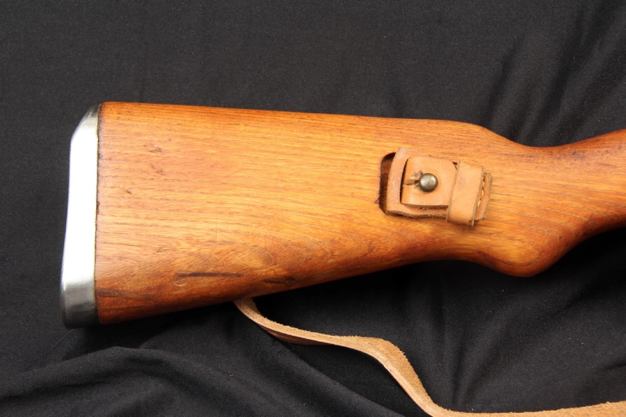

What are your thoughts on the slotted stock style as seen on Mausers?

@ BpSam.- It is often an overlooked method, but mainly because HW positioned theirs a bit too forward in the barrel and people were afraid that tensioning the sling would open the barrel before a shot (more on that later).
I have found two versions of the "RF magazine" ring to be useful: One comes as a thin steel piece that needs to be pried open and then re-closed (my preferred method, but not always available), and then another that has two Half-rings . In SOME cases I do prefer the to half rings as they leave a very elegant gap at the barrel's top, but for strength and utility, the well-fitted pry-open one cannot be beat.
Thanks for your kind words.
@ Dennis.- Don't get riled about my above statement of the HW mount being too far forward. The truth is that since springers should NOT (except for the 54) be shot under tension of any sort, the sling was a pure carry sling and so the position was correct, specially in the days of non-scoped and therefore more forward balanced, rifles. Nowadays with almost all airguns being scoped, the balance has shifted backwards and the forward sling can also be moved backwards.
The ARH ad is typical of the era, my only grief with that style of mount is that is sets the full weight of the rifle on one of the thinnest parts of the stock. Even using a counternut, I would not be willing to do such an installation.
There is another way of slinging the DIANA 34/350/Mauser, but it is so expensive as to be useless, and that is to make a special metal ring thar replaces the "C" clip in the pin that locks the cocking linkage between barrel and piston/extension. It is a custom made part and uses a SMALL grub screw to hold the pin in place, the pin acts as axle to the sling swivel. It can also be done for HW's.
You end up with what HATSAN or GAMO install from the factory, which is VERY workable and convenient, but to do it by hand for ONE gun takes a LOT of time.
