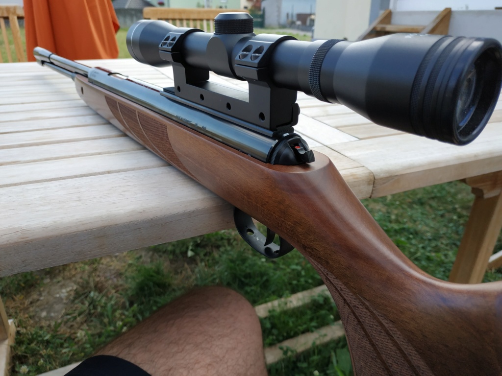

The stock is beautiffuly nice, nothing wrong to say about it :

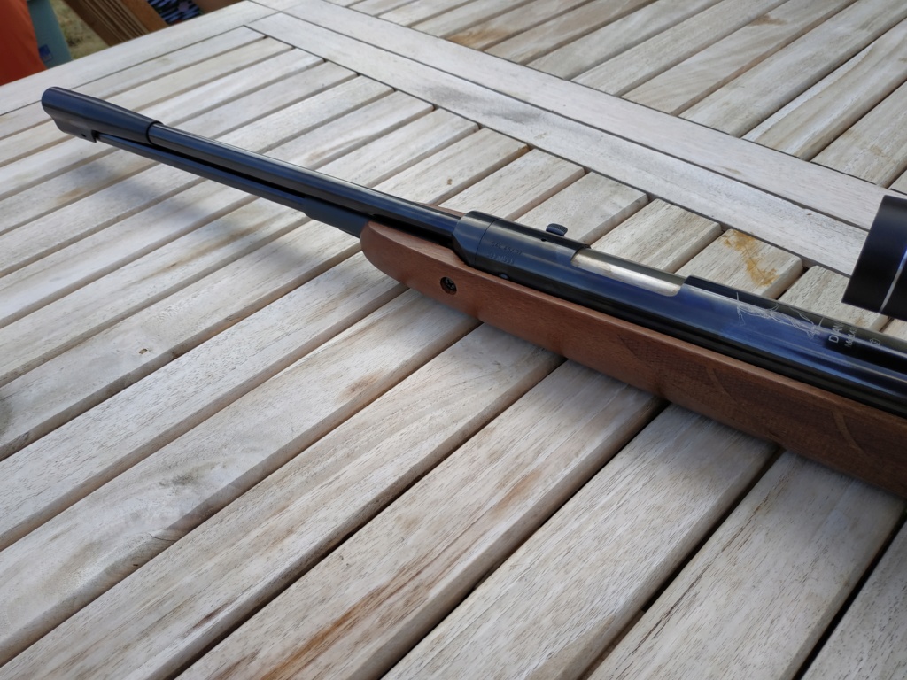

Barrel weight comming from the 470TH :

The burnishing is nice and reflects light how it should, it's not as dark as on my LGU, you see the steel isn't polished to far but it's still nice :
Now shooting with a Hawke Airmax 4-12X50 AO and an adjustable Sportsmatch AOP55 mount.
