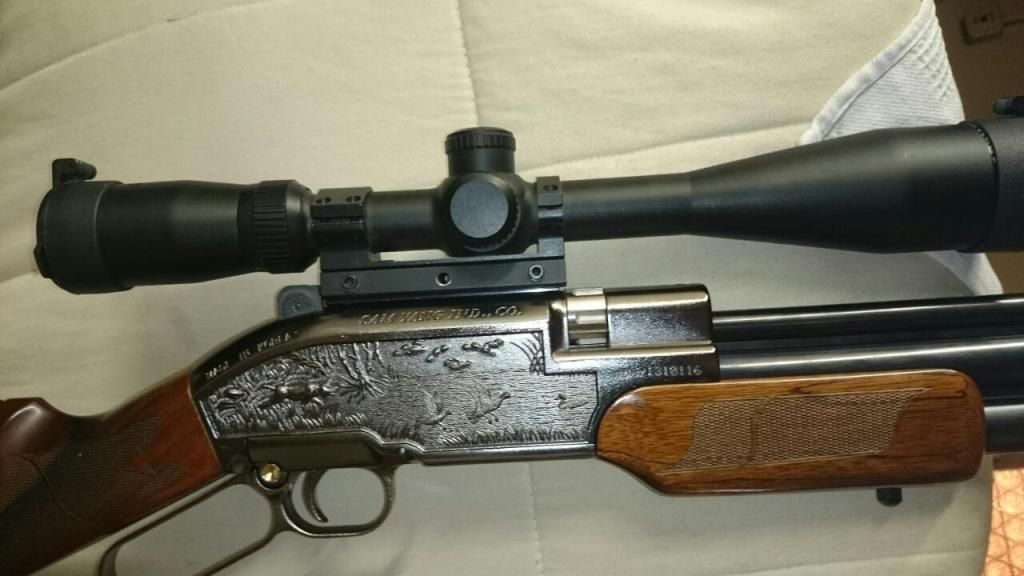

Excellent work and write up.. I have wanted a Sumatra Carbine in 25 caliber for over a year. After seeing your post its time for a Carbine 25 caliber.

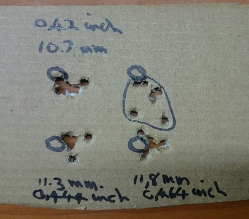

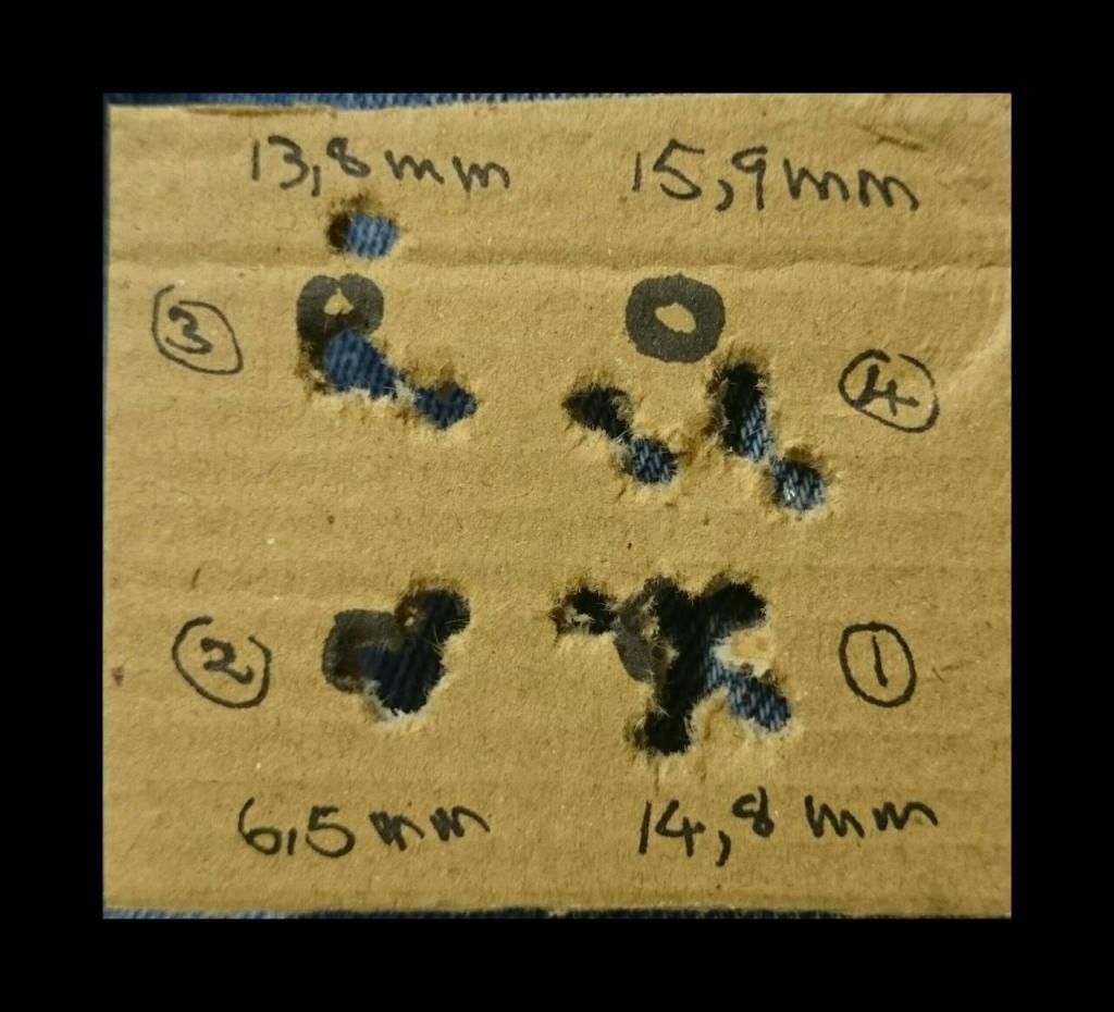

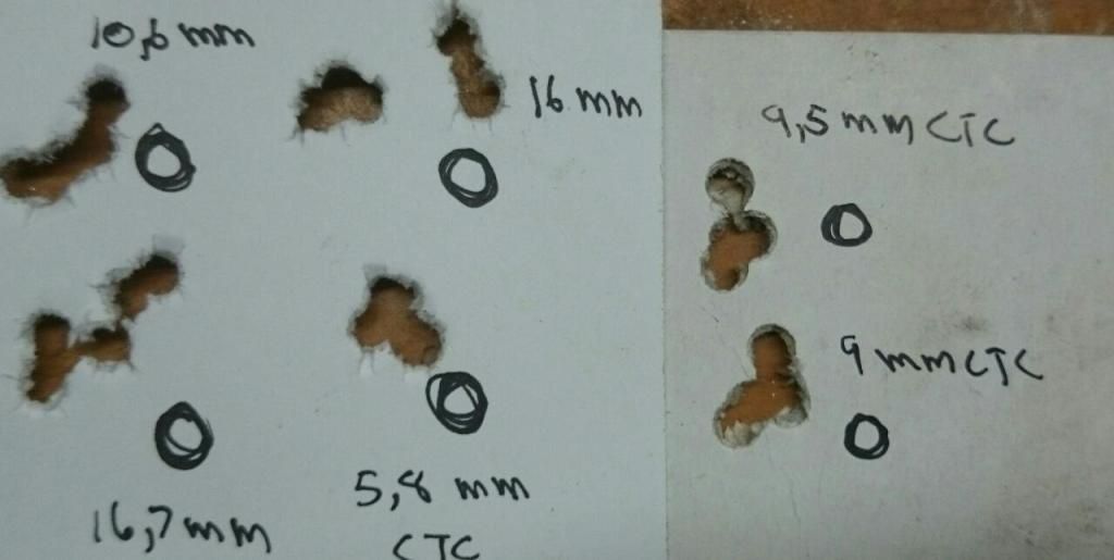

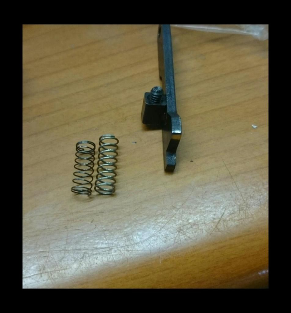

Went back to the factory TP. I now get 18 shots within 3% between 905 and 930 fps with only a 155bar fill down to 105 bar.I'm happy with this setup because I have a 200bar cylinder = a lot more fills.5 shot groups at 44yards 18gr jsb's ...I experimented with different holds...causing some of the groups to wander a bit. That 5.8mm. 228 inch group is my best ever at 44yards.
Quote from: Froggy. on January 23, 2015, 07:15:41 AMWent back to the factory TP. I now get 18 shots within 3% between 905 and 930 fps with only a 155bar fill down to 105 bar.I'm happy with this setup because I have a 200bar cylinder = a lot more fills.5 shot groups at 44yards 18gr jsb's ...I experimented with different holds...causing some of the groups to wander a bit. That 5.8mm. 228 inch group is my best ever at 44yards. Am I following you correctly, you obtained these results by cutting 1" from the factory spring?
