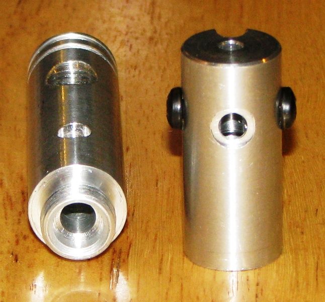

I have an issue with my bolt pattern. Three equally spaced screws, one on the bottom and two near the top allow the valve to tip slightly under pressure. Would one on the bottom and two centered on the side, keep the valve straight? TIA

I would need to see a picture or sketch to answer you bolt tipping question. Generally, to reducing axial tipping, you would want to reduce slack at the front and rear of a bolt, rather than just one ring of screws.

Hi Subscriber, It's the firing valve that tips. The firing valve is long because of the projection on the back of the valve that the hammer rides on. The clearance between the diameter of the projection and the ID. of the hole in the hammer is small. So any misaliment will cause the hammer to drag on the projection. Since the valve is held by two screws near the top and one screw on the bottom, and the screw pattern is close to the back edge of the valve. The valve wants to pivot under pressure like a seesaw. The screw hole spacing is 60 degrees so I drilled and tapped for two more screws opposite the top two screws near the bottom, so now 4 screws are holding the valve and the valve should remain straight. I'll find out today.

Adding stabilizing screws to the valve sounds like the smart thing to do.

Valve is centered now, the hammer moves smoothly along the projection. After that I noticed quite a bit of drag from the new sear, I've about got that dialed out.
