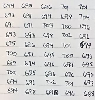

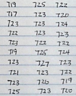

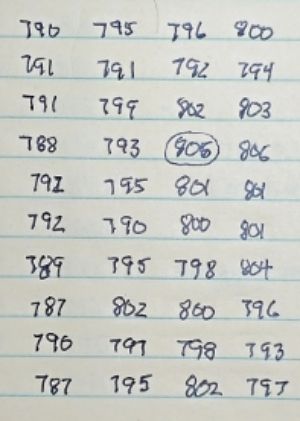

This was with mine turned up almost all the way with the present tune, I could always get more but I figure why cause it's just shooting so darned good the way it is. I have the TSS on it backed all the way off and I'm getting about 13 shots at 30fpe right now with the JSB18.13's in it. It's really all I need when I'm out hunting with this gun.
