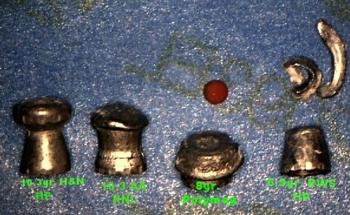

RECOVERED PELLETS:
At thse speeds, the inaccurate H-Points did kind of "blow up". Not unusaly for them to expand, then break off the nose in ring typer fragments, with the little cone base section pentrating seperatly. If they grouped better at this speed (1025fps) would be just about perfect for pest birds at 20-30 yards as they give a fast/early dump of energy (which would be about ideal for small lite critters).
But they aren't accurate enough, so scratch tme off the list.
The PolyMags grouped great, expanded wlll at this speed (988fps MV), and dumped energy reaonsbly quickly and kind of evenly.
H&N Baracuda Hunters didn't expoand much, basically truingintinto a slightly fatter wad cutter, dumping energy faster at the far end of penetration than at the impact point. Not what I'd want for pest birds, as it's more of an energy dump LATER rather than SOONER, and with little critters you don't get a "later".
