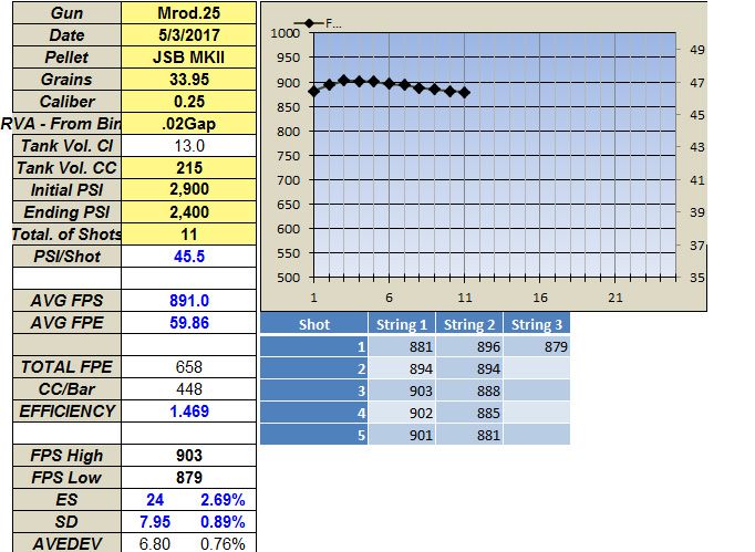

Got that thing drilled On lunch. Took 10 shots from 2700psi around 920-930fps with the 25gr Kings. Going to need to dial that down a bit. that's with the 10lb spring.

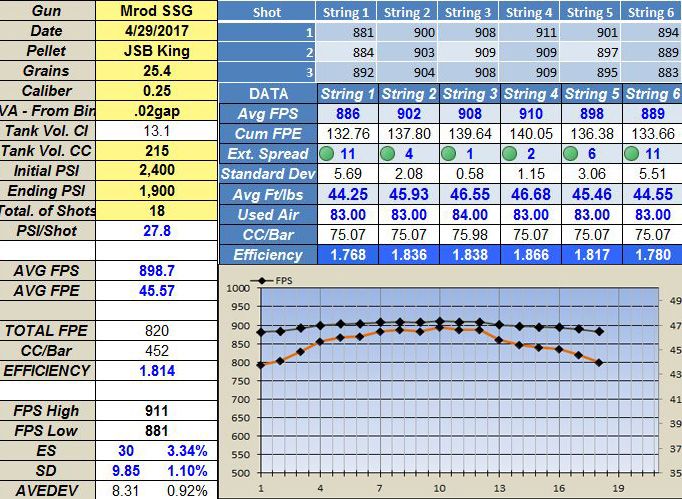

Looks like I need a regulator the way my gun is set up. One set at 1900psi would be about perfect i think. At any rate here is a string I just shot from 2400psi down to 1900psi with JSB king 25.4gr. Lets call this my low power tune. Look at the efficiency! Holy smokes I did a double take when I looked at the gauge on the last shot.

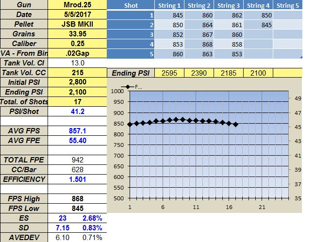

60fpe tune. Not stellar but still great efficiency at this power. Did this tune in 4 shots adjusting from 2700psi. All the power I need for this rifle. I can get more also hit 960fps at 3000psi and still not coil bind so still room for more. This one is pretty similar to the 25.4gr tune but less shots with the 33.95gr MKII's. Went ahead and locked that gap down with blue loctite. I like it where it is.
