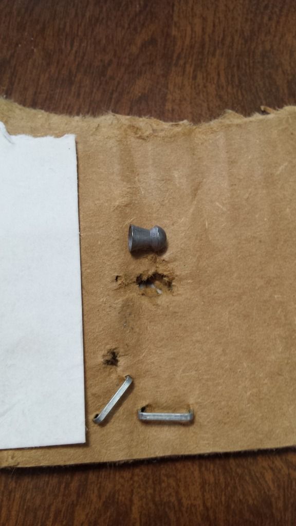

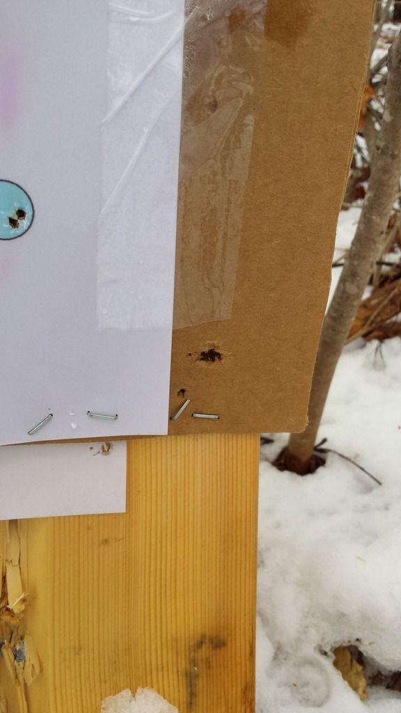

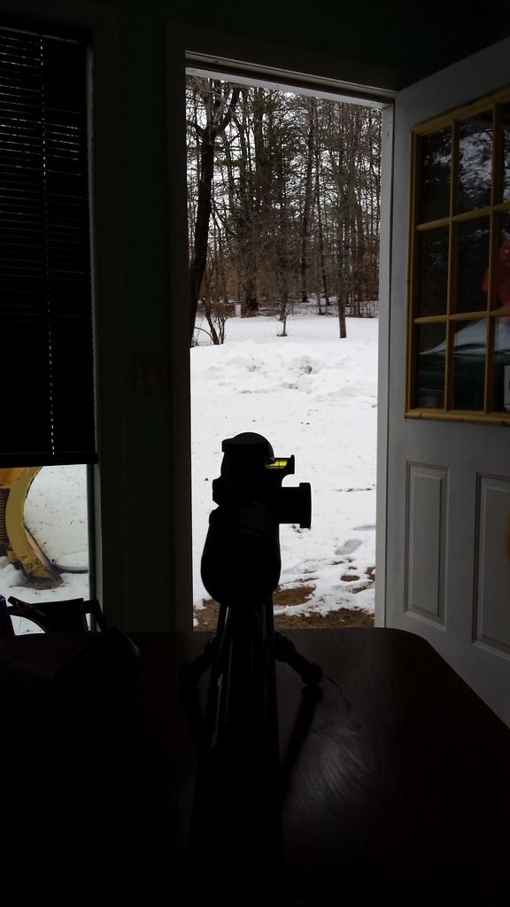

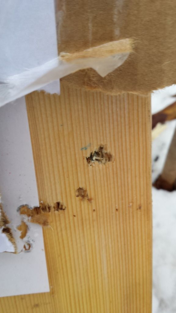

Yesterday, I got to try it out. 30 shots dropped the air from 2000 to 1500 lbs.
For grins, I removed the LDC. The gun "seems" quieter than before the mods.
The trigger is much improved.
I am very pleased with the outcome. Pumping from 1500 to 2000 lbs is a piece of cake. Good exercise.
