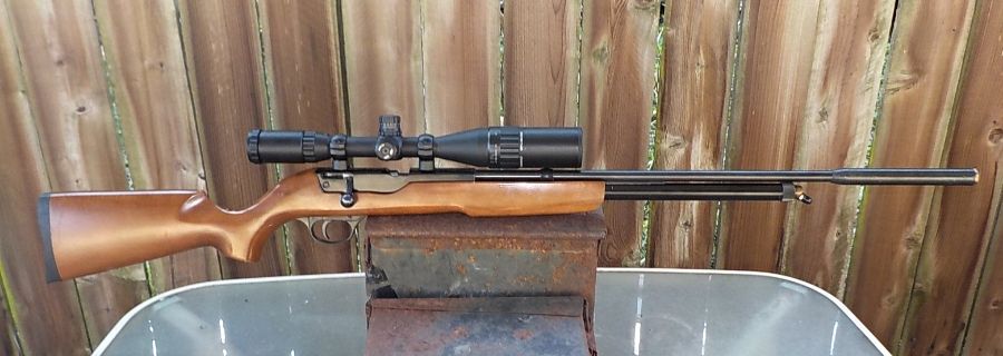

theres that and another one for 200 that not regged.. looks like a discovery tube
http://www.network54.com/Forum/113813/message/1487037643/The+New+Beeman+Chief+PCP+Air+Rifle
