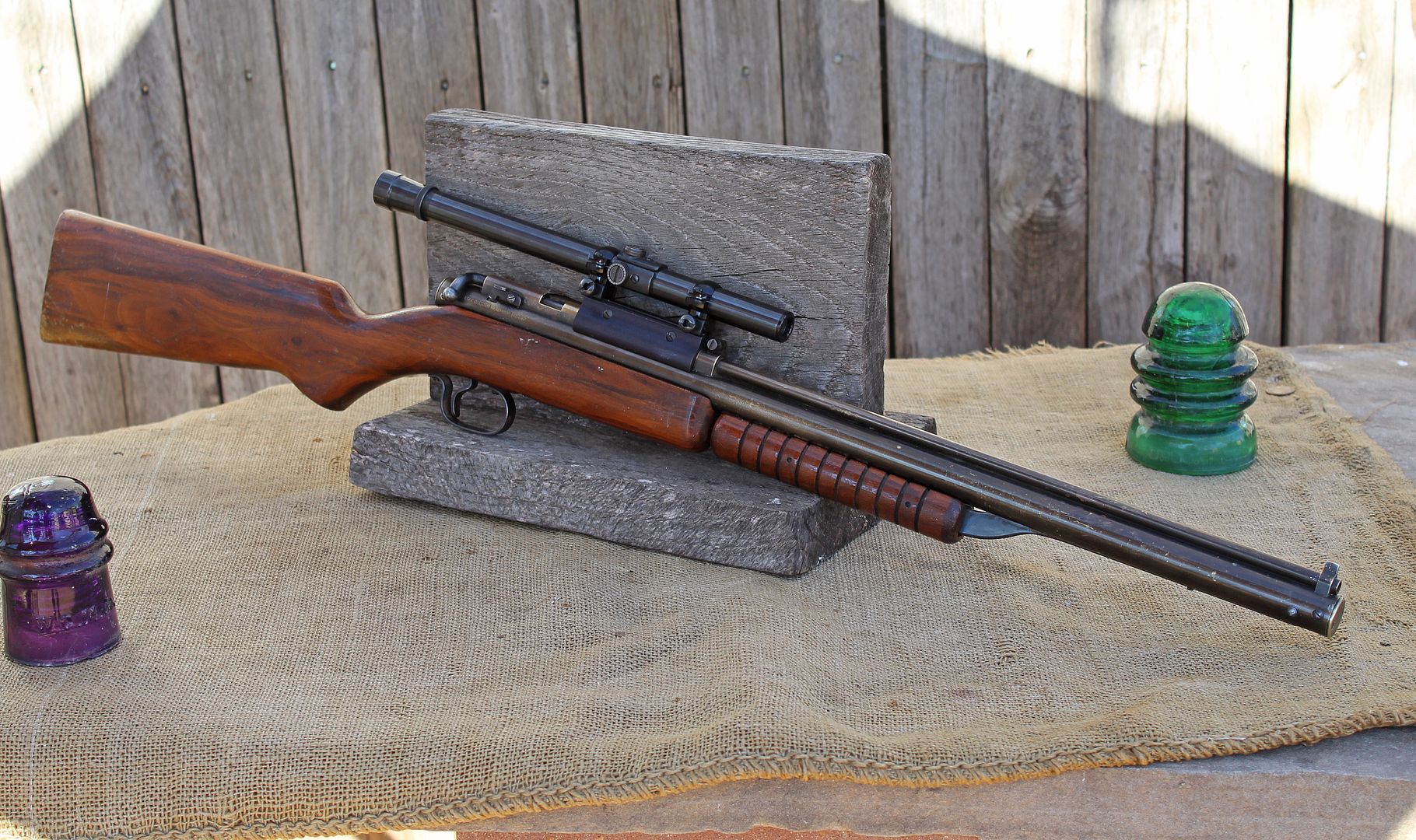

The 312 was shooting a bit slow, it turned out. Put in a new pump cup and, today, took it back apart and reinstalled the original exhaust valve. Could not get a lead seal in behind it to save my life. Found there was one in front of it. Ended up putting everything back together without the rear lead seal. The gun shoots quite well, around 530 with six pumps and a JSB 13.4 gr. Eight pumps brings it up to 570 fps. Used a Sheridan intermount to attach an old Weaver B4. Hits the 1" bull every shot at 20 yards.

Well it's shooting and she looks good. That's all that counts. The valve nut may start coming unthreaded over time? Not sure, but at least you'll know where down the road if it does.
