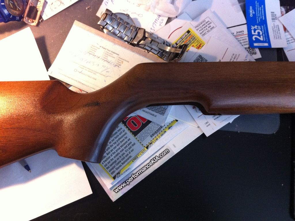

I am thinking about removing a piece of wood from a thumb hole style stock and sanding it down IOT reshape the profile of the wood and then strip and refinish. I would buy a stock Hatsan Flash and remove the action and simply cut , sand and reshape it. Then strip all the stain and finish from it. Finally refinish it and seal the stain with some type of protective coating. Thinking of a deep ebony stain with a distressed finish. Just a little project to do on an inexpensive gun, possibly opening the door for more expensive rifle models in the future. I don’t own any wood models as of now. I prefer tactical looking ones. But perhaps a blending of wood and tactile is possible. I have circled the piece of the rifle stock I would remove, I’m not sure if it’s possible, or what the outcome might be. But it’s just an idea.

I saw a 10/22 Boyd’s Evolution stock with the lower spine removed ‘cuz it was in a state that didn’t allow TH’s and it looked very cool.
Kinda like the stock in the photo but with just a straight grip.
