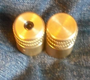

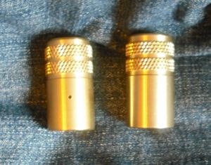

In the "more than you needed to know" category:Odd...but there are two types (or at least there were).One is pretty much solid brass...no screw in the top and no vent hole in the side. That once came with a factory rifle. The other (and I hope tht became the "standard" one) has a screw in the top and vent hole on the side (which came with a later replacement air tube).The one with the screw in thr top/vent hole in the side can be used to either protect the treads when the air tube is detached from the rifle, or to degas the air tube (just screw it on and then screw down the allen screw...which depresses the valve stem...and the air "whissssses" out the little vent hole).The one without the screw in the top is just a thread protector...although with a little work (vent hole and a threaded screw in from the top) could turn it into a degasser.
