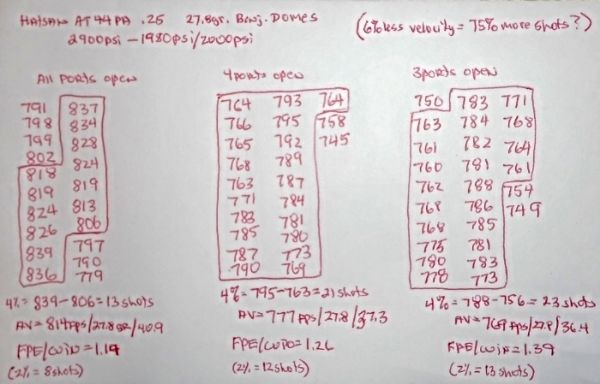

Re: Hatsan at44pa tuning
August 24, 2016, 07:45:25 PM »
Only adjustment is the striker spring tension, and it works like the other 44's (counter clockwise increases striker spring tension...increases the "sweet spot pressure range"...and generally increase energy at the expense of shot count.
If you want to go faster, then will have to (1) mod the valve (likely a thinner.better air flow of the valve stem) and (2)
Mine has become a more or less "pure" hunter. Seldom bother to put it on a bench, use a 4X scope (although it's an old 4XAo version0, and shoot bigger critters inside of 50yards (and the closer the better for my philosophy).
I actually like the pump action, but I was rasided with pump action shotguns so I'm use to the nearly automatic drill of pumping. For me, makes a great woods hunter., but if you're looking fore a bi-pod or bench rested super sniper...keep looking,
