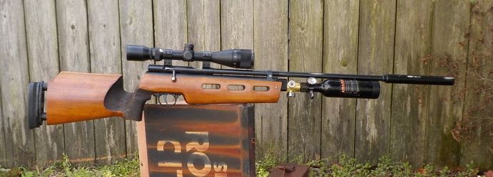

My old friend is feeling kind of sick. It’s my fault, I gutted it and used the striker/striker spring assembly in a different rifle, and now its rejecting the new parts.
Still a 12-13 foot pound rifle running on an 850psi output 13ci tank, but now gets a lot less shots per tank full than it did. Was good for about 140-160 shots per fill, now only manages 100.
No leaking air at rest and can’t find any air leaks at the transfer port or bolt probe, so it’s likely squirting out “extra” air down the barrel too late to add any speed.
BIG clue is that it sounds funny…like a little “buzz”…which would be hammer bounce. Got to cure that to get the old-girl running the way she was running when healthy.

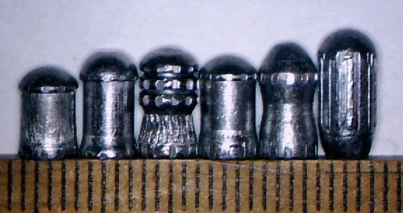

Pellets: (fired/recovered showing rifling)

I’ll get it cured, get back to about 150 shots per tank.
