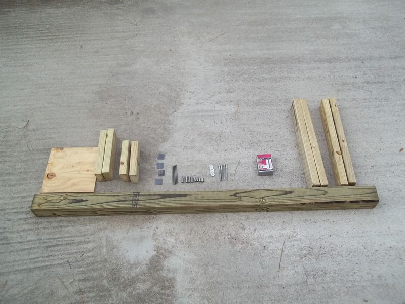

I built me a stand to hold my targets up at a height so I'm not shooting downward. This helps to make clean holes in the targets and not tearing them. I also added some swingers to it, an idea I got from other GTA member that posted how he made his. I set the target at a height so that I'm at a natural point of aim. What I did was once I had the post standing upright I took my pistol and raised it to my aim height and marked the point at which the barrel was at. I took half the box height and from that dimension and that's where I placed the shelf.
Materials for stand
1-4x4x6
4-2x4x24
2-2x4x12
2-2x4x9
1-12x12x3/8 plywood
Materials for swingers
4-5/16"x4" galvanized lag screws
12- 5/16" galvanized washers
4-1/4"x5" rods
4-1/2"od x 3/8"id x 1" tubing
4-1/2"od x 3/8"id x 1 1/2" tubing
4- 1 1/4"x 1 1/4" x 1/16" flat bar

Very clever design! Good of you to provide a materials list.

Nice looking portable stand Ricky. Well done.

I like it a lot!! I should make me one of those.

Thanks Now if I can find the time to shoot.
