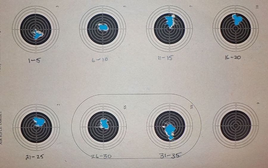

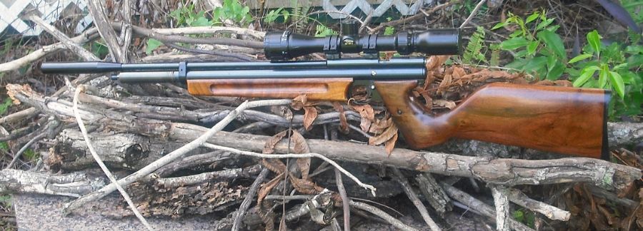

Retuned the old 2260 Carbine/HiPac. With a major change or two, had no real idea what the pressure it would run it’s best, so started with what I thought was a little over-fill and ran it until I was sure it was well under optimum.
Pretty much the LEAST accurate PCP in the safe but I’ve started each hunting season with that old carbine and intend to start this one with it too.
5 shots each/20 yards: Over the years it has changed. Started off as a 12gr. CO2, then morphed into a bulk fill co2, tanker co2, tanker HPA, and HiPac PCP.
Now if the game was keeping all the shots in the black part of the target (call it 1.2 inches) then all 35 shots would be “good nuff”.
Looking at the target more critically, can see that the POI starts out low (shots #1 to about #11), gets kind of stable (shots #12 to about #28), and then falls back low (shot #29 to #35).
JUST FROM THE TARGET, would predict that the “good shots” would be something like the shots from #10 to about #30.

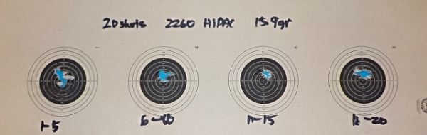

So I filled it to 2300psi and shot 20 shots (my closet approximation of the 20 best shots in the 1st target):
WHAT I’D LIKE TO IMPART: YOU can figure out where the best shots live without a chronograph if you are very picky about POI and have an accurate enough rifle to make 1/8” or ¼” POI shifts meaningful (“meaningful” in that any shift from POI is due to the gun and not the shooter).

#1. Even with just one barrel band, there is no real right-left shift in this one-band version of a Dico/2260 conversion. Is a good bit of up-down variation over 35 shot, much less varation overt the center-core 20 shots, but not all that much right-left shift.
#2. 35 shot target showed that about 20 shots were uniform and good enough to say on a pellet tin lid if I were plinking (even with a +100fps varation).
#3. “Center-core” (or the sweetest of the sweet spot) shots averaged quite a bit better (and more on-target) than the shots with more variation.
#4. PUMP FILLER. Why would I want to put 49 pumps into a rifle to get 35 shots that varied by ½” (2900 – 900psi) when I could put 28 pumps in for 20 shots (2300-1870psi) that vary by 1/16th inch?
