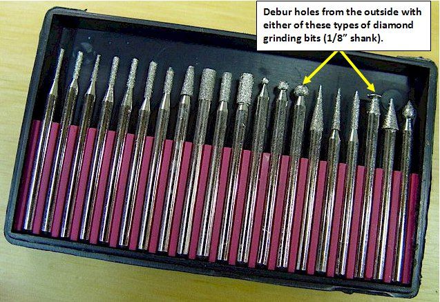

I checked Bob's thread and maybe I missed it, but I'm having a hard time picturing how one might drill the barrel port without removing the barrel. You mean without separating it from the breech block?
In any case, I'm usually able to reach in with a 1/8" diamond ball (from the same direction a pellet would be loaded) and round over the edges of the port. That is, using a Dremel tool on low speed, rolling the ball back and forth lightly over the sharp edge to give it a slight radius.
If the situation prevents you from doing that, you can use a bit like the one on the right to reach in from the same direction you drilled the hole. Notice how it's shaped like a cone with a disc on the end? What you do is catch that little disc on the lip and debur it that way.
I hope this helps!

when drilling holes i a barrel or something similar put a tight fitting dowel in it and drill thru into the dowel this should eliminate the burrs for you
you can also use a small dental burr from the top side to get them out
