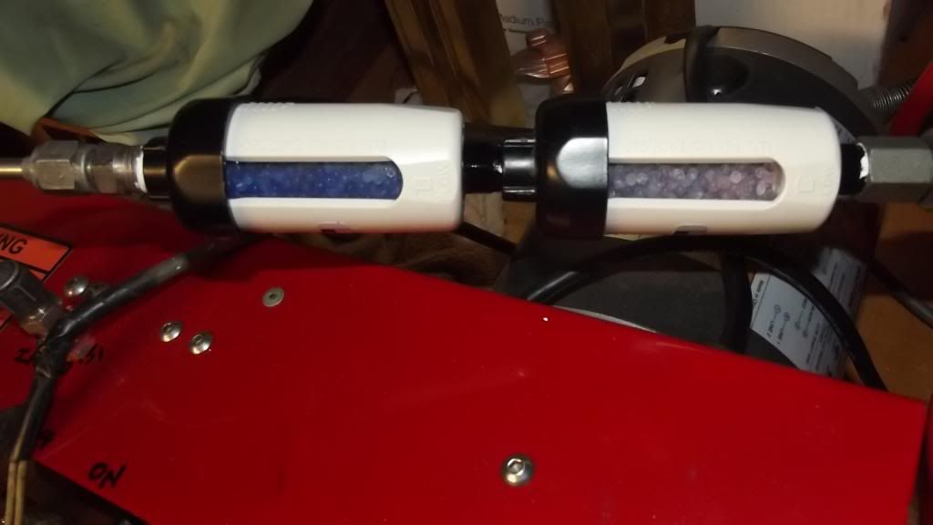

A dry air system should help with the condensation issues and like others have said to be careful of overfill!!!
