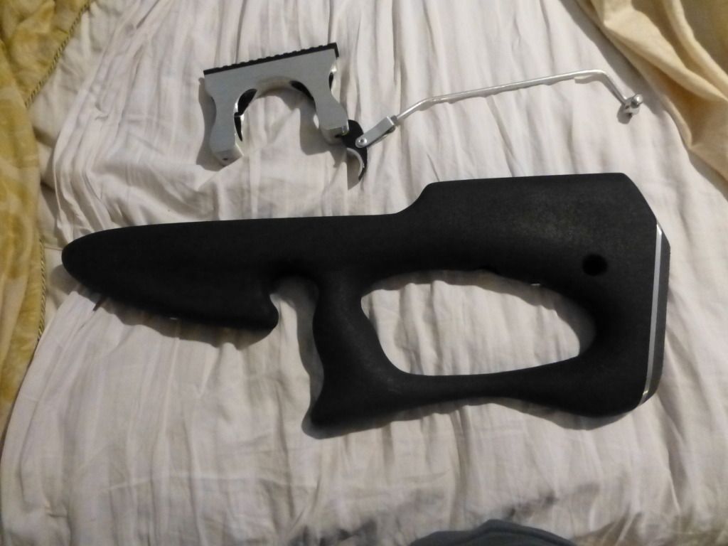

Well guys I am back into projects for the pcps.
Latest Evanix RS2 9mm is getting a new dress.
Here are some pics of the start and now in the final stages of finishing the wood.
http://i1326.photobucket.com/albums/u643/FANG59LOBO/P1000487_zps7ade447d.jpg
http://s1326.photobucket.com/user/FANG59LOBO/media/20150606_161541_zpsd68ee4d7.jpg.html?sort=3&o=0
This stock was an early version of the marauder. The wood was a thick like plywood material. Not easy to wood rasp.
panted black now for the final block sanding and curves.
Looking like it may be a black stock right now. Scope and trigger is the same aluminum block pictured in yhe start pics but yes modded for the RS.
THE old bullpup stock I had at the first has been fitted for the RS a while back. The wood on it is a super solf wood that cracked many times while working. It still is now project # 2. With some work it is coming on fine and vould be the new Windy City bullpup?
Yes playing once again. Now loving the power and accuracy of the RS2 9MM and for sure the RAW 1000X 9MM REGULATED.
THANKS ALL!!

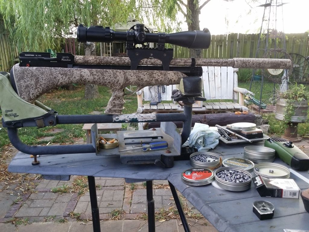

Thanks oldpro very much. Took the time to work the pictures so to be able to post them without anyone having to chase them down.
Still working the trigger hardware. The big rod setup was too much for the stock new config of the RS2 placing of the tube and receiver. Got the thing working super till the stock was installed?
Still working on it and taking another approach.
Here is some pics. One you will see the WAR Bullpup (WICKED AIR fully modded Marauder.25) on the left and the RS2 Bulldog on the right.
THANKS

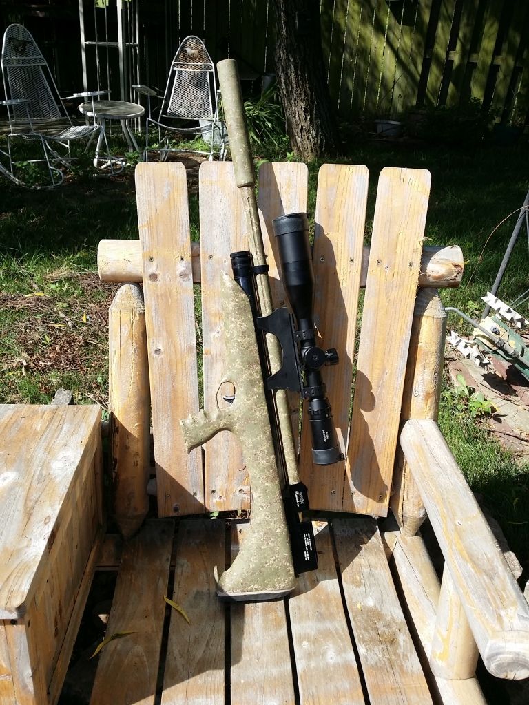

Still waiting on the trigger set up?
But I have to say this project has proven a great makeover.Not had time to stretch it out? New scope, super low mounts and now I just had to throw some od green on the dress. So many colors of OD. This is the lighter more green not the dark.
The gun is a laser. Scope is almost on the plane of the WOLF air LDC.
Next project is the PP upgrades.
