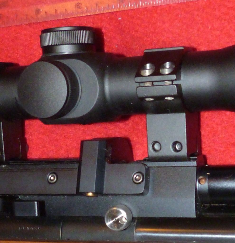

Actually, after getting home from work today, I changed out the UTG (Leapers) 30 mm 2-piece high rings for UTG 30 mm 2-piece medium rings. The mounted scope is a Hawke Endurance, 6-14X 50 mm on an AirArms S-410 XTC. Barrel clearance went from just under 1/2 inch to around 1/4 inch. Clearance of the underside of the scope went from just under 3/8 inch to about 1/16 inch.
2-piece high rings:
2-piece medium rings:
Again, the limiting factor for scope ring height for the AirArms with a removable magazine is more likely to be clearance for the magazine rather than the size of the 50 mm scope bell.

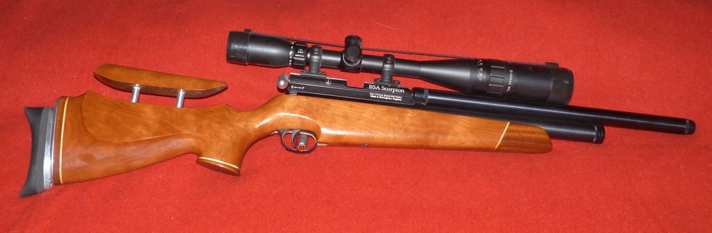

Thank you. A word of advice, based on my relatively limited experience with PCP's. The *problem* with PCP's is that the compression tube is mounted under the barrel, between the barrel and the stock. The result is that, in a conventional stock, the barrel of a PCP sits about 1 inch higher than the barrel of a powder burner barrel in the same size stock.
My second and only other PCP is a BSA Scorpion .177. It came with a carbine stock and is a much smaller, lighter air rifle (which was the appeal for me). Unfortunately, the original stock was all but un-shootable for me. Even mounting the scope on the barrel, little more than a lower jaw weld rather than a cheek weld was possible. And it was nothing near a fit for my large frame. This necessitated a custom stock with a riser cheek piece and an adjustable butt piece for the stock. This added time and more $ to get the BSA "right" for me. The custom stock is pretty much a stylish copy of the original carbine stock modified with a cheek riser for a LH shooter. Notice what it took to put the stock at the proper level? Worth the investment? Yes, indeed. The BSA Scorpion wears a Hawke Varmint II 6x24 42 mm mounted with two-piece dovetail to Weaver rails and Burris Signature Low rings. The bell of the 44 mm scope is within a couple of millimeters of the barrel.
