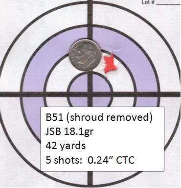

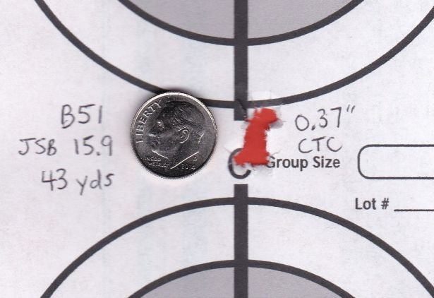

But the .22 cal pellet that puts up absurdly small groups probably more than any other? Yep, the very same 18.1gr JSB that groups best in your Disco.

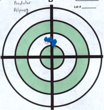

For example, my B51 would do ragged holes with Polymags at 25 yards:
I was pretty excited when I saw them grouping like that but when I tried them on my 43 yard target, they opened up considerably. At that distance, the JSB 15.9gr and 18.1gr really shined:
So I usually try the Polymags when I'm tuning a rifle but I've yet to have them group as well as the best domes at 40+ yards, and the bottom line is the most effective hunting pellet is the most accurate pellet.
