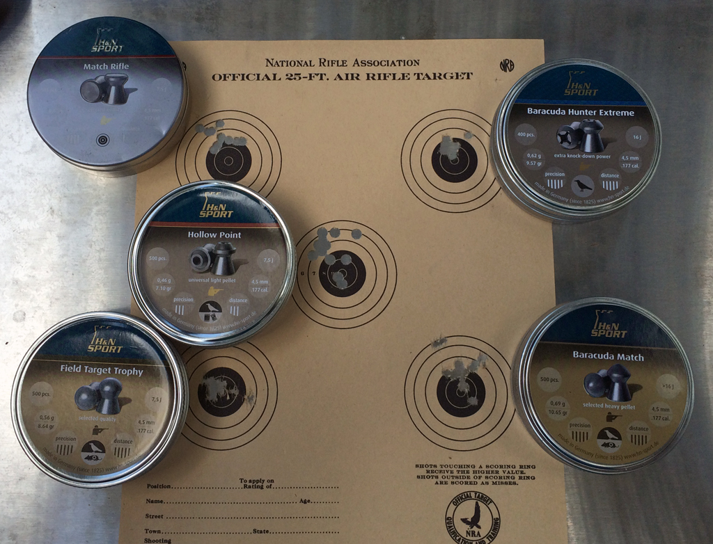

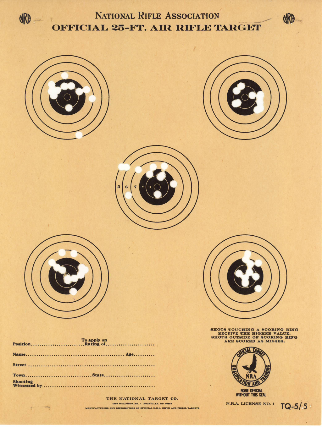

I will let the pictures do the talking.
All were shot with the R1 shown. 18 power setting, AO adjusted, reasonably firm platform rest shot sitting. 28 yrds (measured) slight wind right to left, 10 shots after each pellet change to "scrub" the barrel and then 10 shots for record. All shooting was done with a light hold, somewhat like the artillery style hold using my support fingertips to index off the scope rings.
No sight adjustments during the shooting.

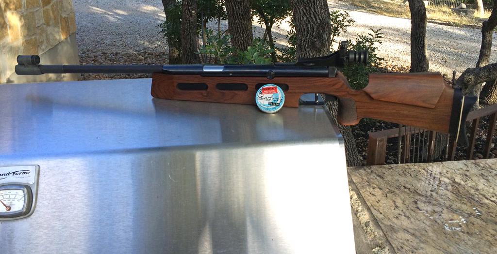

Here is my R1 and the scope setup.

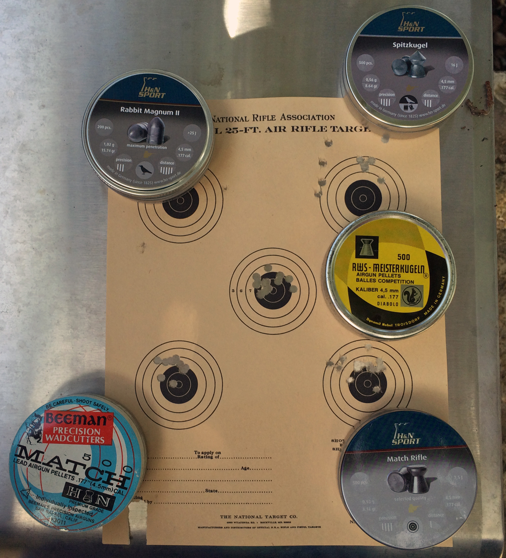

On the middle target, the tin to the side is the correct one. No pellet holes were covered.
I normally shoot Barracuda's out of the gun. They work well and I like how they load. Silver points are good also but I am inconsistent loading them. Crow magnum are good. Barracuda Hunters are excellent while sports scatter.
Match rifles did poorly while barracuda Hunter extreme and field target trophy did well.
Rabbit magnums stink. Actually only the 2 pellets shown even hit the paper. One other pellet banged up my target box pretty good. The other 7 pellets? Who knows. Spitzkugel did really poorly.
My last three where some old beeman pellets and RWS target pellets from the 80's as compared to modern match rifle pellets. Interesting to see how the older target pellets did better then the modern ones.
So next order?
More other pellets to try as this was kind of fun.
Field target Trophy's
Barracuda Hunter Extreme
Baracuda Hunters
Baracuda's
Maybe some Silver Points and Crow Magnums.

Always interesting to see evidence of how much pellet selection can effect accuracy from the same gun.
Hope you are enjoying your R1. I have shot mine a lot recently and it is fast becomming one of my favorites.
IMHO, 28 yards is plenty of distance for good accuracy testing.

"Rabbit magnums stink. Actually only the 2 pellets shown even hit the paper. One other pellet banged up my target box pretty good. The other 7 pellets?"
After reading your very useful post I have just been out trying to learn to hold my Diana 350 Magnum [.177] - it does jump around a bit, but gradually is becoming smoother and I am learning to relax and not try so hard. I happened to have bought some Rabbit Magnums recently as I am wanting to hunt rabbits so I tried some. I know where 5 pellets landed - about 6 inches or so low and right from my aiming point and with a 'group" size of about 5+". I do not know where the other 4 went at about 15 yards range!
I might have to melt them down for fishing sinkers. They are a total waste of money.
