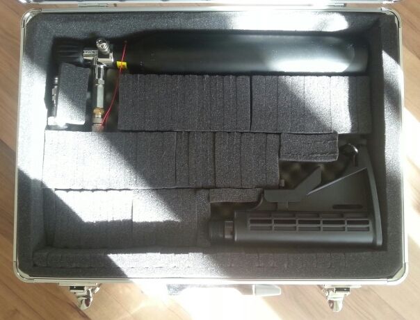

This Is how I started to fill it. Today I also have a targetholder (BSAs folding one) and room for a laser range finder (on order, have not arrived yet). The tube is 500 cc filled to 260 Bar.

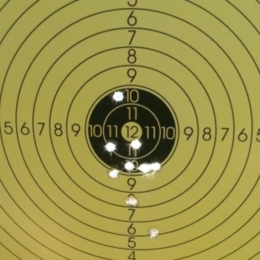

The 1701 holds factory powerlevel at 3.50 fpe and is indeed very accurate, at least indoors. This is 10 shots with JSB Premium shot at 21 yards indoor, fully rested and not cherrypicked.

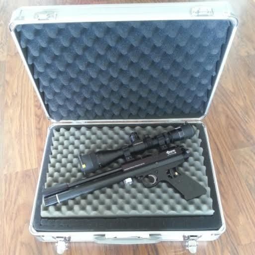

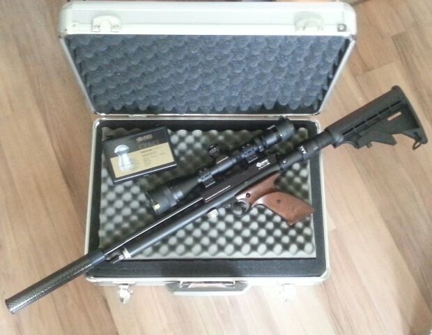

An early pic during its build, showing how the 1701 fits into the first level of the case:

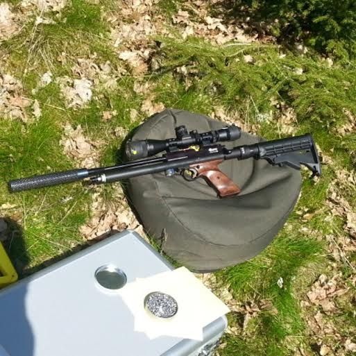

I took my bicycle out to the farmland during a wonderful spring evening, some mixed pics..

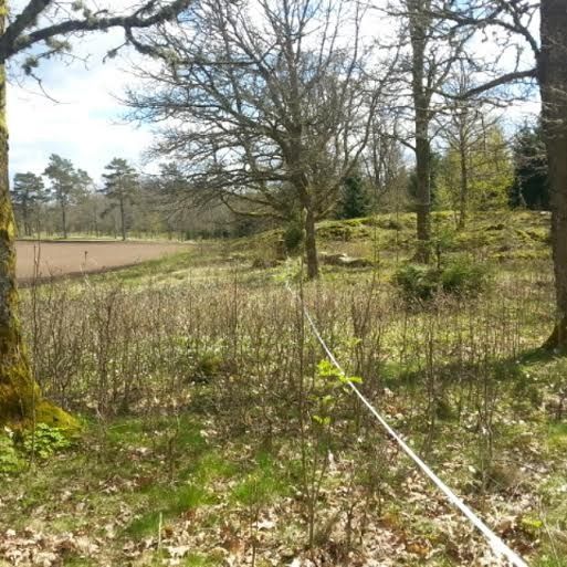

A range of 33 yards looks quite far away for the naked eye...the white stripe is the measuring tape..
