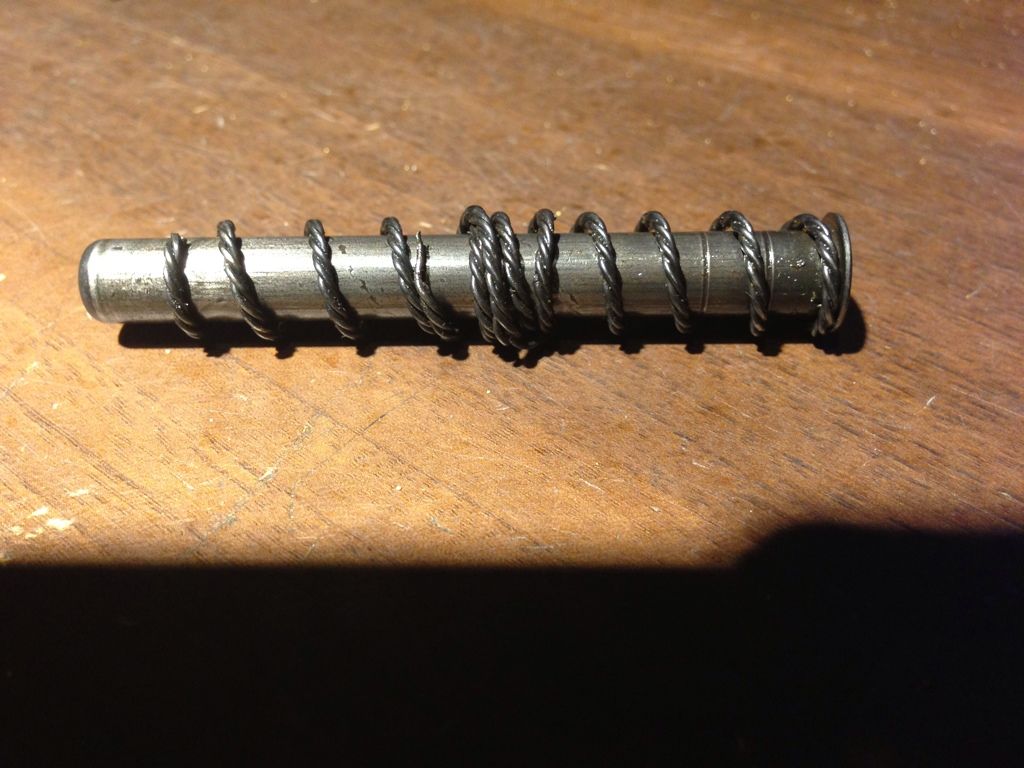

When you said dual wire spring , I thought you meant dual-wrapped wire spring ? Two wires wrapped together, then formed into a spring
Last Edit: March 10, 2015, 08:53:49 PM by HillGSA
shorty
Posts: 1936
Real Name: Tim
Re: dual wire hammer spring (video uploaded)
Reply #26 on:
March 10, 2015, 09:07:24 PM »
That's a stranded wire spring. My spring is a parallel wound spring.One spring backs up the other. Twice the lb/in in the same area while maintaining a linear function. I have only seen this type of spring once ( longer and smaller diameter used in a desert eagle 44 auto mag) for the slide. I then copied it years ago ( many years ago) to prevent bolt bounce with an open bolt fully automatic ruger 10/22.

March 11, 2015, 06:26:58 PM »
Hill,
So here's what my spring looks like. What I find really interesting that you recently posted about your 25 cal 50 shot string post. Mine is a gen2 .22 shooting 25.39 but I was able to hit "almost" your exact tune for your 25 at 42fpe out of pure luck.
