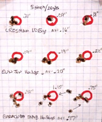

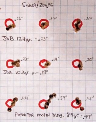

Last time out, tested 6 potential .177 pellets at 20 yards. Only the best 3 of those 6 moved on to 40 yards.
Considering I was driving them too fast (+20 foot pounds) for the lightweights to make the cut, were not that many pellets to test.
The “winners” of round 1 (and I’d not have predicted this as I’ve had less than great luck with Crosmans):
So these 3 moved on to 40 yards. When I get a chance, the top 2 of these three will move on to 60yards.

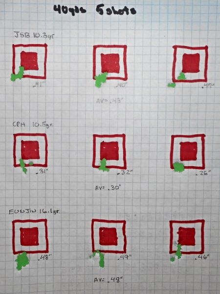

40 Yard results:
#1. I need a bit of right windage, but didn’t want to add fumbling around with the scope as a variable, so lived with it.
#2. Do NOT take too much meaning in the drop at 40 yards as they were not perfectly sighted in at 20.
#3. I have no clue why the Crosmans did so well. Considering my record with Crosman pellets, it’s not unheard of, but pretty rare. Did notice they chambered with that nice feeling of snugness, so it’s probably a diameter difference.
Draw what conclusions you see, but until I get some 50 or 60 yard shooting, will let the guns that prefer the JSB’S enjoy them and just sight this one in dead on at 40 with the cheaper Crosmans.

Some barrels just plain like the CPHs.... I know a few FT guys that use them, simply because of that fact....
