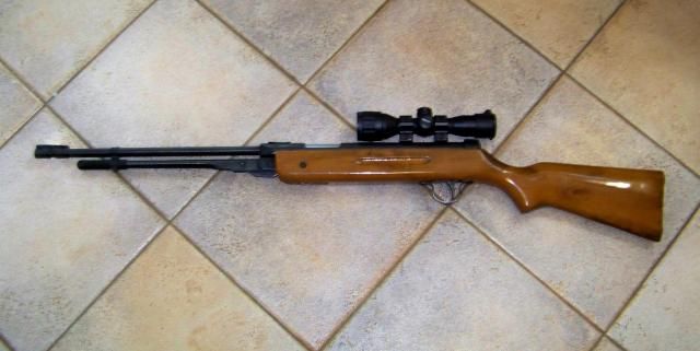

Hello I am new here to this site and I have already been given some great information on some of my air rifles. This morning I found one that I did not know I owned. It is a Chinese under lever air rifle in 177. It has MAOEINSHANGHAI CHINA on the receiver. The rifle cocks and fires but no pressure. I assume the seal on the piston is gone can someone help me with what I have and where to get new seals?

Sounds like a industrie b 3 1

Shane, sounds like a B3 to me also. Google B3 parts you'll see a site top of page. He's got the parts you need. Look for B3 parts.
Google. kermitairgunclub.com they got step by step directions.
Lack of power may just be a breach seal.

Another suggestion is call Mike at Flying Dragon AG's he is a member and vendor of Chinese AG's

I believe the B3 used a leather seal. These dry out over time. Try a couple of drops of silicon oil. It may come back.

Thanks guys for the info it ended up being the breech seal was gone and I tried all the parts places and no one had them I ended up using a faucet rubber washer and it works fine.

Archie has the springs IIRC.
