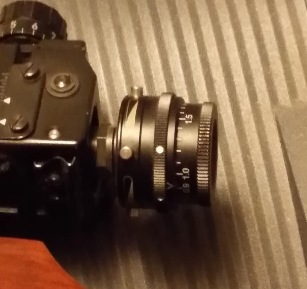

When you can buy an adjustable iris like the Gehmann, Centra or Anschutz and the Gehmann is $52, why struggle with drilling out fixed irises? Mine is a little more elaborate with filters and polarizer.

After the 753 arrived and I shot it a few times it was obvious that the aperture supplied with the rear sight was too small. I tore the sight down and retapped the M9 aperture mounting hole to M9.5x1 so that I could use my Centra Iris.
re 9.5x1 tap
I could not find the correct tap but found that the standard 3/8 x 24tpi tap is so close that it worked just fine with both my Anschutz and Sentra iris.
I have encountered no problems with either of the two sites that I tapped with the 3/8" x 24tpi over the past year.
