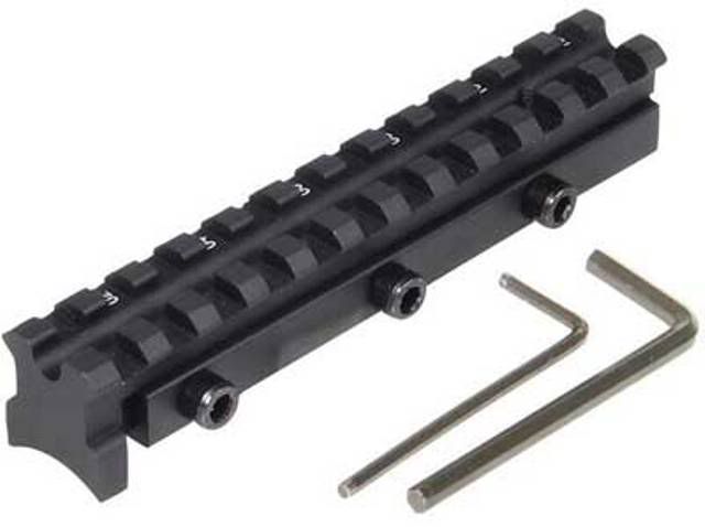

i am waiting on a 11mm to weaver adapter from air scopes here, last night at the gun club a fellow shooter had a spare adapter that works great on a diana 34 which the air hawke is a china cope of, all except the dovetail on top, so for general knowledge, if you shoot a ruger air hawke the rws 34 11mm to weaver adapters will not work....so....
what are others using if you are shooting a ruger air hawke?? i am going to use the adapter that is ajustable for barrel droop, any other options??

What part of the mount didn't work? Doesn't fit the grooves, slides back, can't clamp it down?
More info is helpful here.
My leapers/UTG 1-piece mount works great, although it is not a weaver adapter mount but holds great and no slip.

interesting, i'd also be curious what part of it didn't work.
I'm shooting an airhawk; also with a 1pc leapers mount. Mine however is offset.

from doing a little research the rws 34 has a raised rail and the ruger does not so the one for the rws was to high to even come close to bolting down

these are made specific to rws but wont work on the ruger even though its supposed to be a copy of the 34

When people refer tho the Air Hawk as a copy or clone of the Diana 34 they mean the internals. The Leapers mount is designed to fit the raised rail of the Diana. The front "lug" hangs over and prevents rearward slippage. By the way, with the articulated cocking arm and piston sleeve, the Hawk is more of a scaled down clone of the 350 than the 34.
