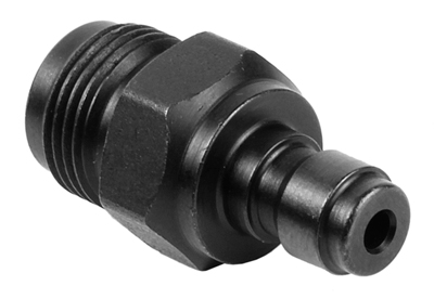

I found some of these at a local paintball shop. I attached them to all the probes I use. PA sells them also, but they were only $5 at the paintball shop.

It was sold at a paintball shop and the owner assured me it was rated at 5000 psi. This is not the actual picture, I found this picture on ebay just to show the build make-up. But it's a silver finish like this this picture.

This is what I replaced my fill connector with from Pyramydair. For my Sam Yang Recluse, the Sumatra may just take the same fitting, I called and they told me to use this and eliminate the factory one. Just screw off the original and install this one. No need to empty the air either, the check valve is under this.
Link--
https://www.pyramydair.com/product/quick-disconnect-male-fitting-o-ring?a=2841
