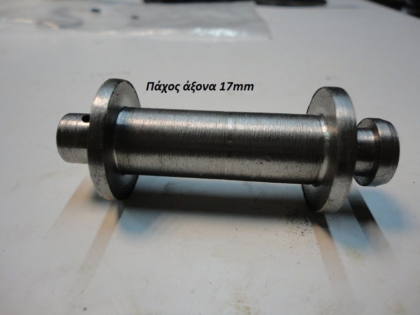

I don't know about making a lighter hammer,i know about making a heavier.
The original (i think you can make it lighter)
and the one i made
the short reg 44 went to 40.6 fpe and 20 shots 200-160 bar using cudas 21.1 grain with no tension on the hammer spring
and up to 60 fpe for less than 10 same shots at full power.
The how to is here
One other think you can do is remove the apostate there is inside the hammer,
the tension of the spring will be a lot less.Also check with gun uncocked the back stroke of the hammer,
the anti bounce system works well if it can go back 1-1.5mm,if more the hammer strikes again the valve pin
and air is lost for nothing.If less than 1mm the gun won't cock.
