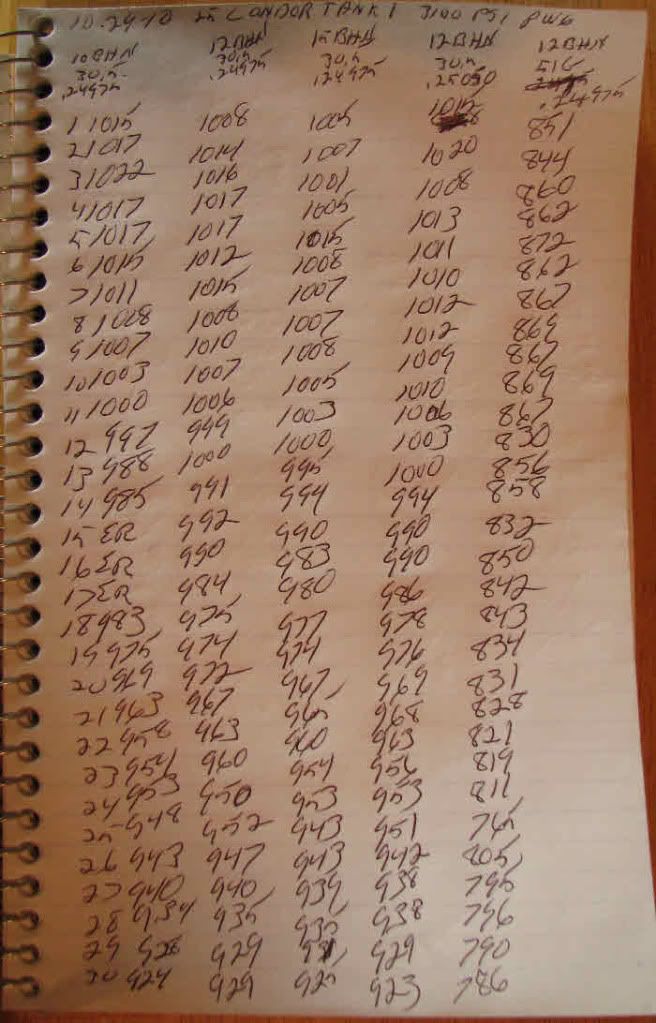

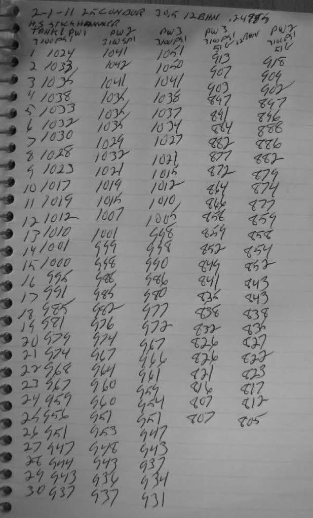

Removed the heavy hammer and went back to the stock hammer set up . But I replaced the spring with a stronger one . I have a working P.W. now , a little more power , and it appears to be managing air better . Ran out of time to really get it set up or match up all 4 tanks . Will play another day .Marvin
Before
Today

Are these strings with H&N Baracudas? It's kind of hard to read your writing on top.. String #2 looks a lot like what I get, but I only fill to 2500-2600psi to keep the velocity down. I have a 90 gram hammer and stock spring. I refill after 32 shots (2 x 16 pellets in the Philips holder) and my last shot is usually in the 940's starting at 1045-1050fps with 31gr Kodiaks.
I now switch to JSB 25.4gr Kings after the pellet holder is empty of the first 16 Kodiaks. This way the JSB's are not supersonic. I find the JSB's a little more accurate than the Kodiaks and they have almost the same POI at 30yds. I can also shoot more than 16 JSB's this way. I usually shoot 24 JSB's after the initial 16 Kodies, and the velocity is still in the high 900's (960-970fps) and POI does not change much. They are rediculously accurate in the 900 range (both pellets but JSB a little more).

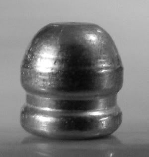

Top page all but the last string are 30.5 home cast . The last string are 51 grain home cast bullets . Bottom page last two strings are 51 grains . The rest are 30.5 grains bullets not pellets . These will carry 65-100 yards with moa accuracy . Were pellets normally fall short Marvin
30.5 grain
51 grain
