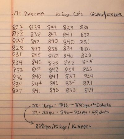

177 Pnuema:
Which works out to about a FPE/cuin of 1.27 (or a BAR-cc/FPE of 12.9)

Some thoughts about that:
1. Same pressure range and same volume of air being used per shot.
2. .Observation is that the .25 has about 80% more BASE AREA than the .177 pellet, and the increase in energy is about ½ that. Basically the same pressure has a larger area to push on, so transfer more energy.
3. With the larger bore volume, the air that is used per shot will exit the barrel at LOWER PRESSURE in .25 than in .177. Same air volume per shot filling a LARGE air volume ( a 20” .25 bore) will exit that barrel at lower pressure than a 20” .177 bore.
4.The energy the pellet carries has to come from somewhere, and the only somewhere is the air released from the shot. So if the released air is the same and the pellet carries more energy, then the exiting air carries less.
It’s low energy for a .25, but impressively quiet.
