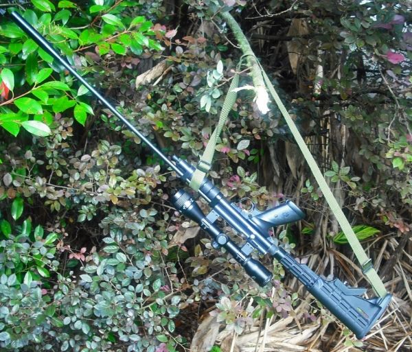

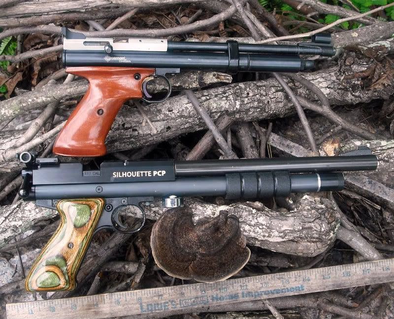

Aren’t many things the HiPac unit actually does BETTER than a PCP. One of the few is to make a small pistol. Just smaller than a 1701 to allow it to be a holster gun. Won’t get a lot of shots from a 2240 HiPac (its only about 33cc’s) but can get decent power from a 10” .22 barrel for those few shots.
If you select components carefully with an eye to weight, can work out a small volume carbine based on a 2240 that comes out well under 5 pounds including scope and mounts.

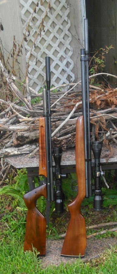

Money wise? Better off starting with an XS60C PCP with pump ($305) or a Discovery with pump ($400). Think you could put together a simple 13CI HPA QB79 conversion, with pump, for about $390-$400.
