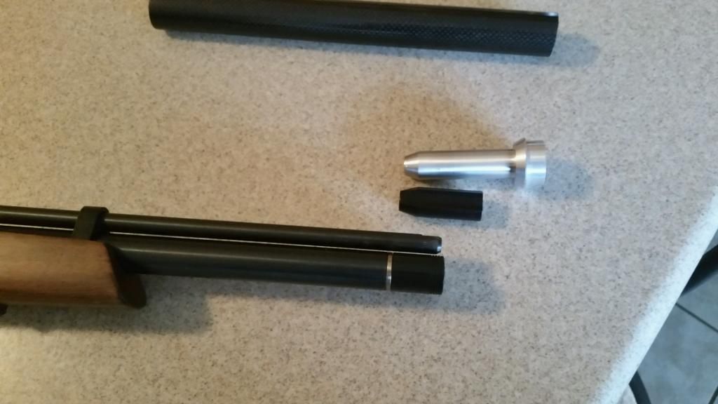

First I looked at the factory muzzle cover and the fill probe cover. Adding something to the end will require some tapering action as well as a little extension. And also will HAVE to incorporate a channel cut to allow it to slide over the reservoir.
I made my measurements twice, wrote them down and measured again. Then set out to the shop to slice and dice. Here is the factory piece below the adapter I machined and the CF tube I am using.

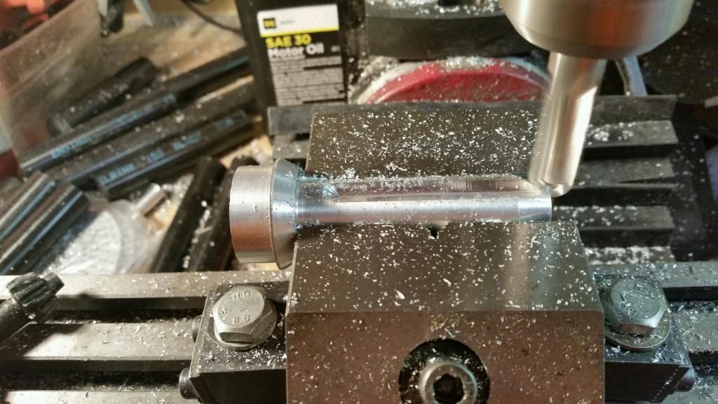

Next was back down to the shop and strap it into the mini-mill. I milled the channel so it could slide over the reservoir without putting tension on the barrel.
After a bit of hand sanding to get the EXACT fit, I dry fit everything together. Drilled and tapped the setscrew hole.

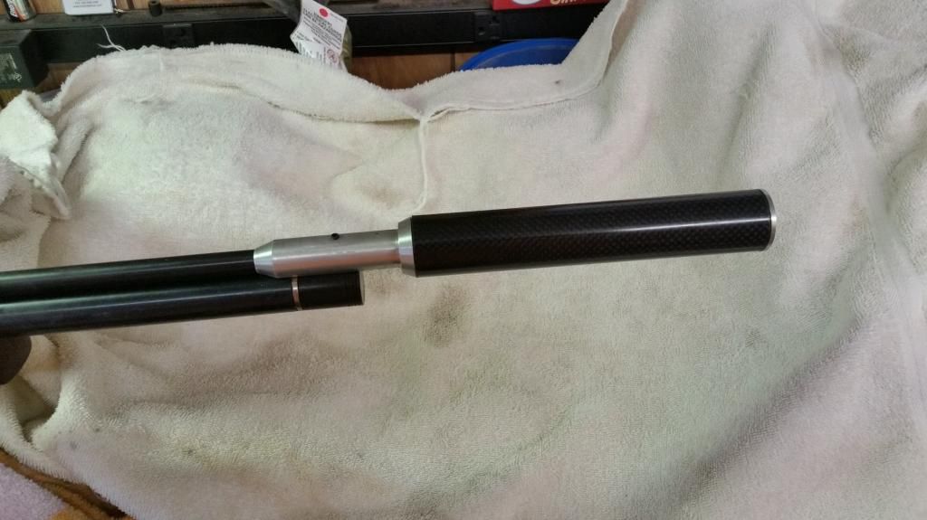

After getting everything to look and fit the way I wanted, I applied several coats of Birchwood Casey Aluminum Black to the adapter end. I left the crown end cap natural machined aluminum. Almost used brass but noting else on the airgun was brass.
Then I added the stuffing and epoxied it all together. This evening I get to test fire.

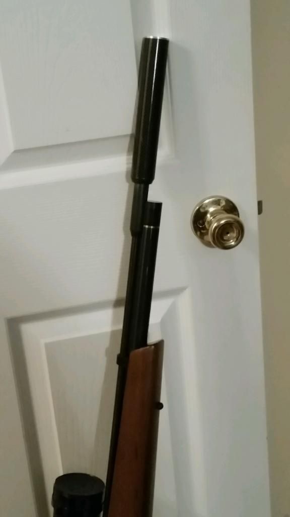

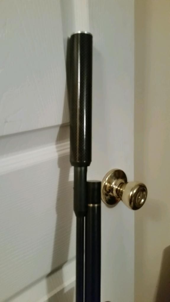

Hope it works...LOL
Was good therapy anyway, whether it works or not. And can be removed and factory crown cover replaced in a matter of seconds.
