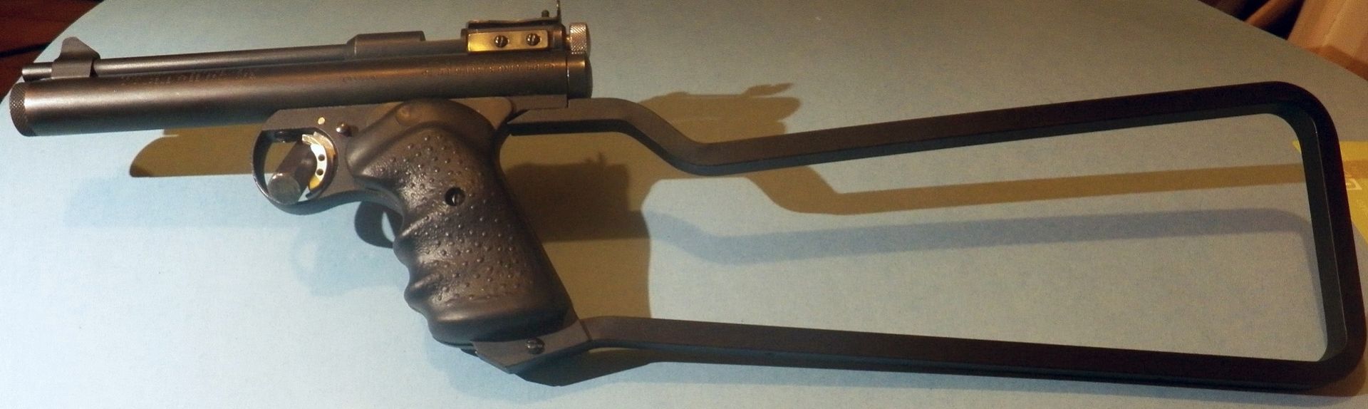

Here are some grips & stock I found on Gun Broker & Ebay. They are on a Sheridan E9 .20 Not a real powerful pistol, it shoots 14.3g @ 410 fps, but it is LOUD. Just a fun gun.

Nice little carbine... Are the grips and stock actually made for the E9 or were they for a paintball version of the Benjamin? Liked those old paintball guns.

I don't know for sure but I think they were paintball related. The grip frame was the same for most all of the Ben/Shrdn E/EB type pistols and some of their paintball guns. Grips & stock are a perfect fit on the E9 which was made in appx. 1991.
