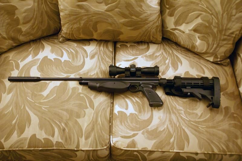

Hopefully a shameless plug of my 1322 build could help with your decision making.
I love the carbine look.

That looks pretty sweet, how did you adapt that stock? I assume it belongs on a tippmann. how do those muzzle brakes work for you? I like the idea of keeping it a bit quieter but just wonder if they will affect accuracy any.
