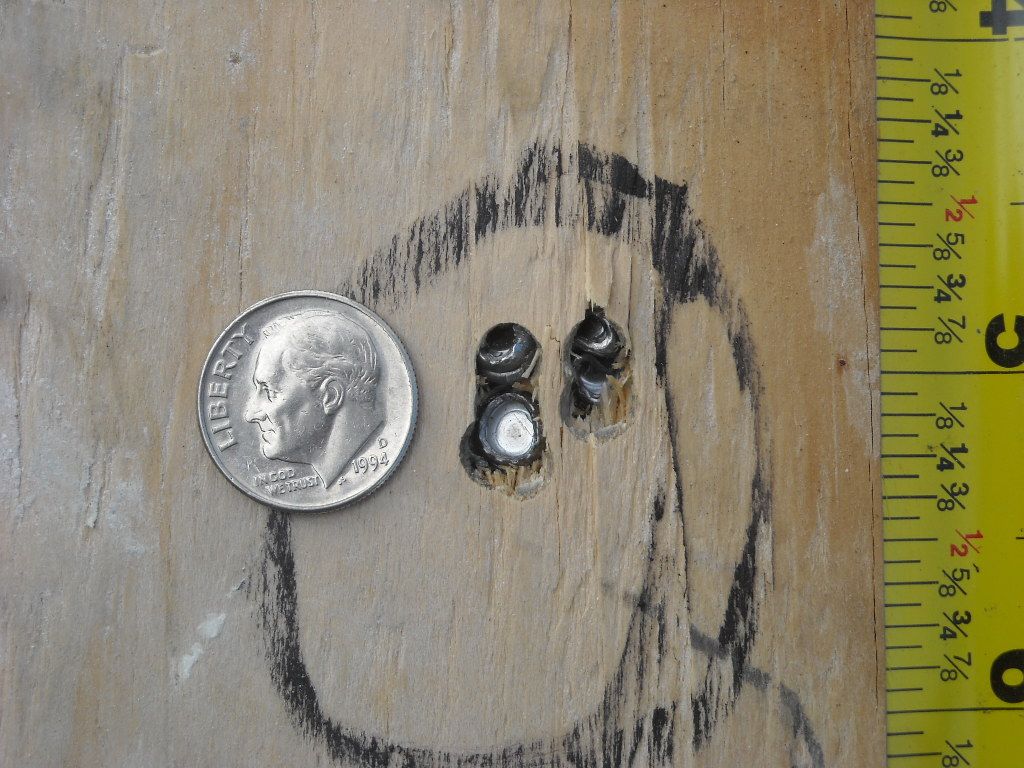

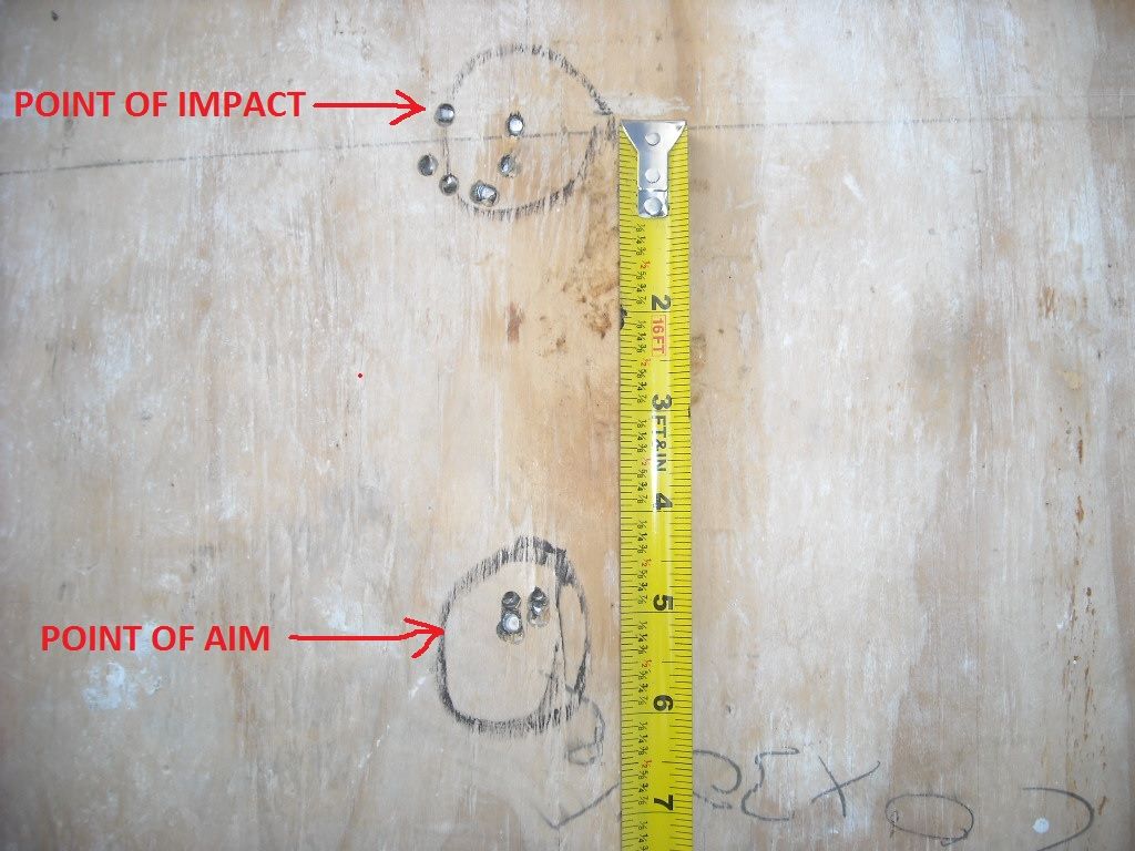

Step 1.) Mechanically centered my elevation and windage adjustments on the scope, then went out and shot a group at about 25 yards. This is what I got, (see picture).
As you can see, the gun is shooting about 5 inches high,,...and windage is pretty decent.
Step 2.) I removed the scope and shimmed the front mount. I used a paper Business card and trimmed to fit the scope mount. Tightened everything down and went out to shoot another group. This is what I got, (see picture).
Not bad at all. There are 7 pellets in that group, shot from about 25 yards using a sandbag rest. I STILL have not touched the elevation or windage adjust screws, since the original centering was done at the beginning of this post. Just got lucky, with the initial centering adjustment, I guess. Now I will have to see, over the next few days, if the rifle Holds this zero adjustment......In the Past, it has not done so. But, NOW the scope is mechanically centered and there SHOULD be good EVEN spring tension on the crosshairs.
