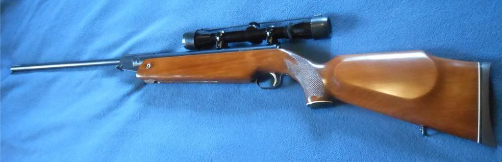

I just used a water bottle and cut shims to tip the scope parallel with the barrel
Here's how I've made a "few" drop compensator mounts...It works and is so easy to do...
I have a RWS 34 and am considering shiming under the scope mounting rail to compensate for barrel droop. I think I can build a ramp the length of the rail using sucessively shorter strips of soda can material in layers (4-6) to gradually raise the rear if the rail. Brass would be another option. Sloping the entire rail would allow the scope rings to remain perpendicular to both the mounting rail and the scope tube. The scope would remain parallet to the rail, and point slightly downward from its original position. Has anyone tried this?Yes, I know about the droop compensating mount and ring combinations.
Quote from: GunnerAl on February 21, 2014, 02:19:05 AMHere's how I've made a "few" drop compensator mounts...It works and is so easy to do...Thanks for the idea. When I do this I'll use two part epoxy putty. Comes in a stick. Cut off enough for the job, knead until it's an even color and apply. It's less messy to work with and great for filling gaps.
Yeah, I've used that stuff too. I first saw it about 20 or more years ago. I don't know much about its stability or shrinkage factor but it cures pretty darned hard alright. The stuff I used came in a stick too, like a stick of candy with an outer and an inner part, each different coloured. Looked so good it was tempting to take a bite, but that wouldn't go down too well in your guts, I'm sure. Like you said, you cut off as much as you needed and worked it together 'til it was all one colour then put it where you wanted it to be, and it was done... Over here it was made by CRC... Actually I still have a stick or two - good thought..!!
I like the apoxy idea. But isnt it much easier and better ton just bend the barrel? High end gun manufacturers do it, field target people do it, I tried it twice and it worked perfectly. POI is exactly where I want it with the scope zeroed and not one detectable negative side effect. I wish I would have known this before I spent money on 2 droop compensating mounts that I d.id not need. Maybe for some reason a barrel cant be aligned to the rail but I cant imagine why
